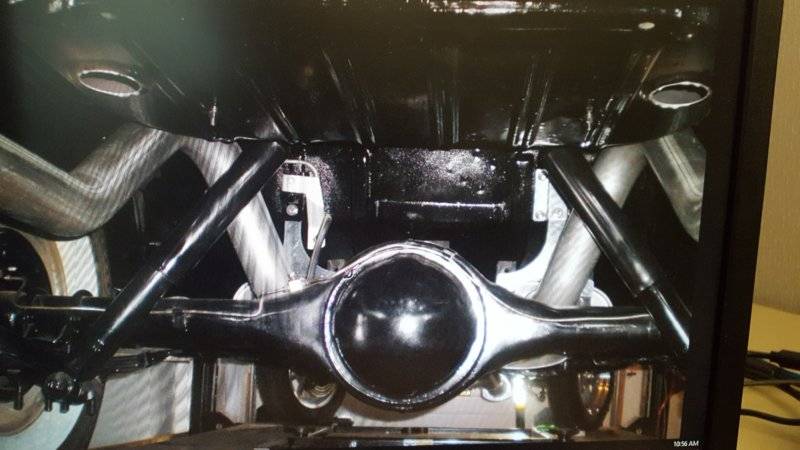

I see them on ebay for later b bodies but those say they are for the driver side. Need one for a 1964 b body for the passenger side. Even just a picture of what it looks like would help me. The kind that bolts to the body for cars that people ordered with dual exhaust.
I put TTI exhaust on, driver side is stock mount, passenger was TTI mount, no different from driver side.
I took this pic from this site, but mine is the same.
Did you drill holes in the body to mount that bracket? I think both mounts are almost identical but a mirror image of each other so they a little different. I'll probably just make my own custom one.

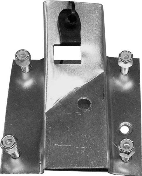

This is the one for later b bodies but it says its for the drivers side and it clearly looks like it's meant for that side since the bend is angled in a specific direction.
I drilled holes to mount the passenger bracket, pulled the rear seat and there were dimples where the mount holes should be, there were a number of them in the same area so I drilled a test hole first.
Dimples on the driver side where the original mount is spot welded.
I'm pretty sure the only difference on my driver side is an additional bracket bolted on for the brake hose.
The brackets are identical, the hangers are offset, so they are a mirror image of each other.

The O.E.M installed body brackets are not identical,there is a right and left as shown above,after market may very.
