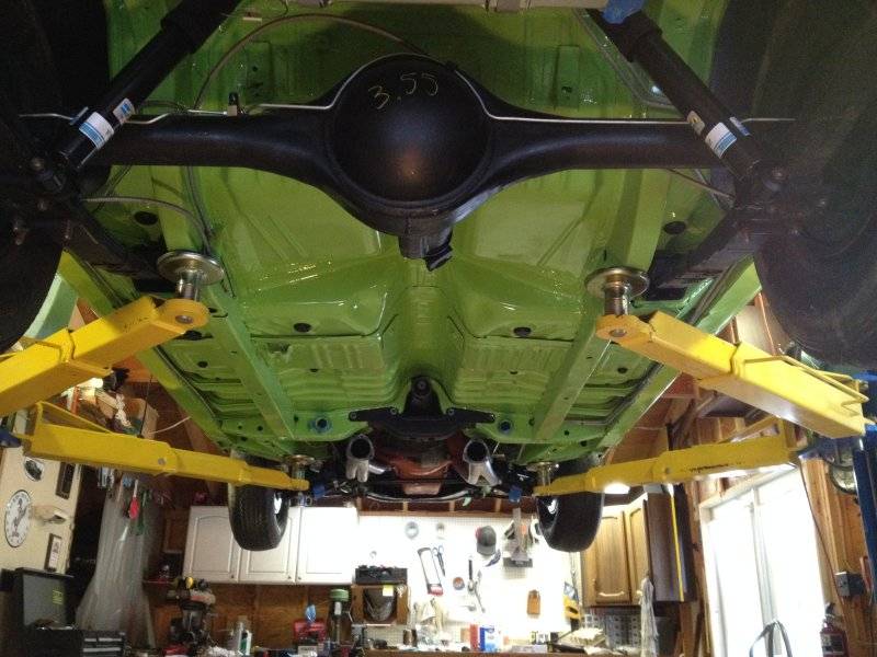

I don't have a great picture, but my car (1970 Road Runner with factory 383, 4 speed and hemi suspension) has the bracket on both sides. My floor was never replaced, so this is original.
The passenger side is welded while the driver side bracket is bolted on.
Top of this picture has brackets.
Here is the driver's side. You can see the bolts.
Hope this helps.
