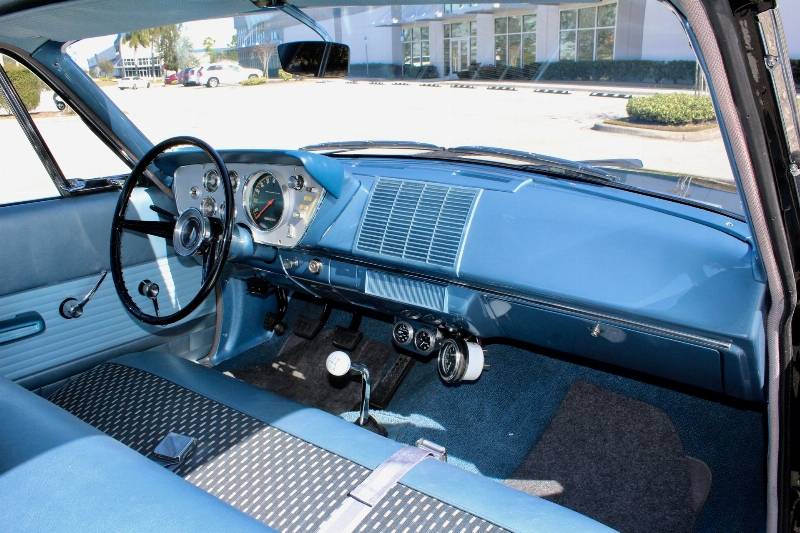

Hi guys, was hoping someone with a 62 (63-65 would probably work) split bench could measure the wide of the vinyl around the outside of the cloth insert, like from the edge of the seat in on the bottom and top/ front and back.. My seats didn't have original covers and i'm having some made but have no idea how wide that is... Pic of seat of the type i'm trying to mimic, thanks

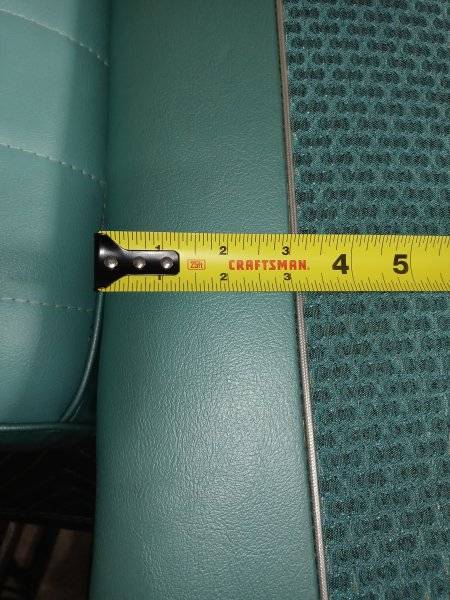

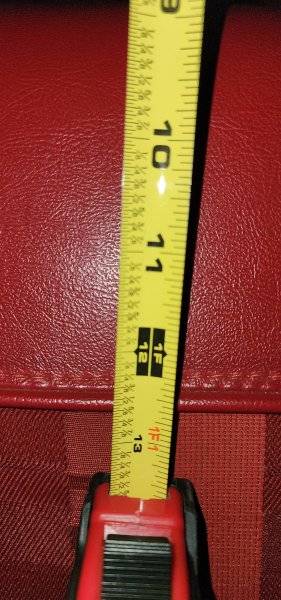

i-t, here's my '63 front bench. The cloth arcs somewhat, across the length. I'm guessing the dimension you want, varies year and model, and material used ? Mine is 3"- 3 1/4" across the front, and they have been redone.

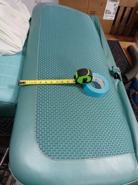

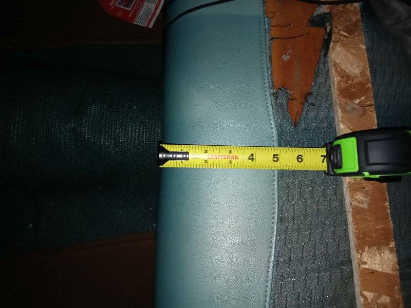

This is my '65 Coronet survivor, 5" :::
Looks like a range of 3" to 5", depending on model ???

Wow, thanks a ton.. i thought it was going to be like 6-7" from pics... i woulda been really unhappy :)

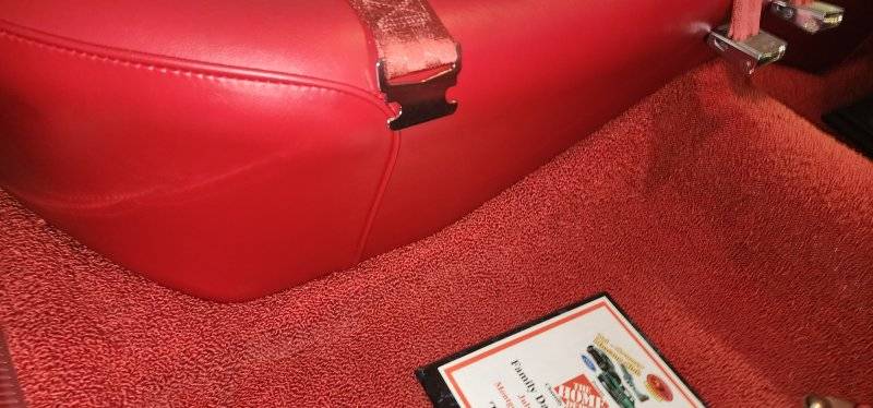

The measurement is from the bottom 0f the seat to the seam where the cloth meets. The picture of the seat corner is how it looks on all 4 seat corners.
Thanks a ton! that will help... and that cloth is a trip, i like it :)

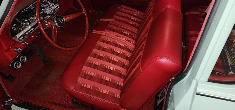

It's original seat cloth reproduced by
SMS. There was enough of the seat covers left that they were used for the correct layout.
