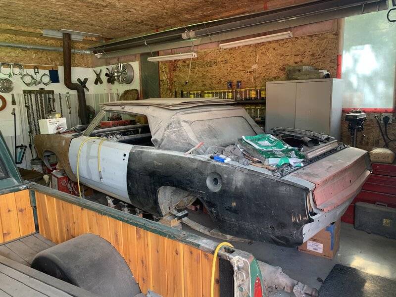

Would it surprise everyone to learn that a 392 hemi is over 100 lbs lighter than a 426 Hemi? Compared to the 440, they are about 70 lbs heavier. They aren't "Boat Anchors" as everyone believes, but they are true Elephants! Replace the anchor intake, water pump and housing with aluminum amongst a few other changes I will be doing and you are well under 700lbs and very close to a 440 ;) i have built stroked 440-6 motors before, always wanted to do a Hemi. This literally fell into my lap, so I am going the check the box. Not completely sure what it will go into, but the 68-70 B-body is top on the list. Always wanted a '70 Coronet RT Convertible..........

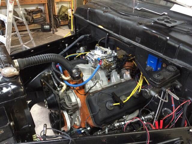

56 DeSoto 330 in a 52 Dodge B3B PU. The truck has manual R&P (88 Dakota front clip) but isn't hard to drive at all despite the weight.
