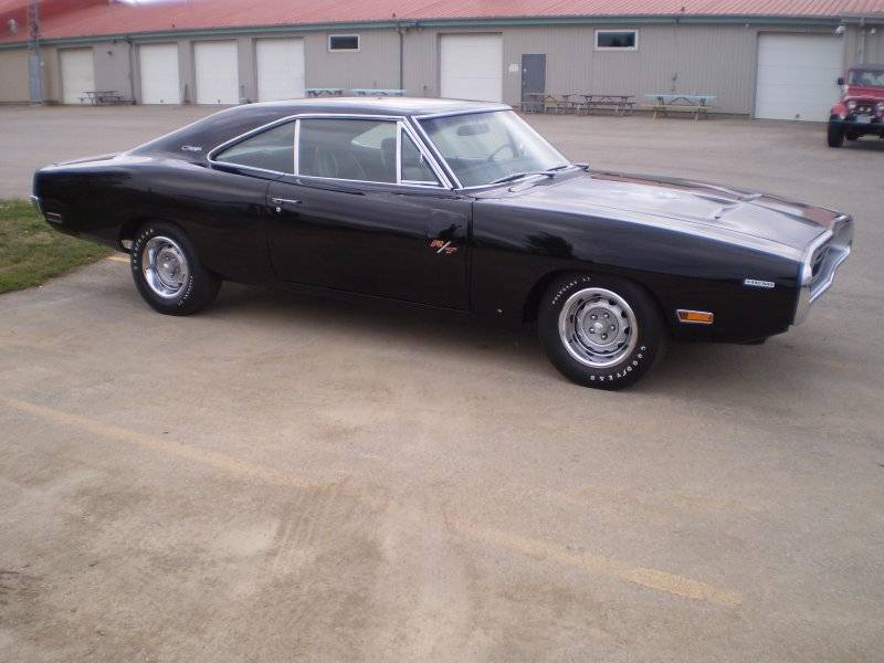

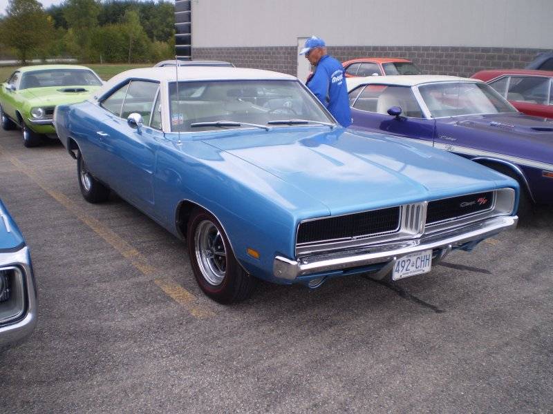

The '70 fenders would be made to accept loop bumper, so I imagine they would be pretty blunt on the front. The '69's would have provision for inset grill. Side marker lights are different shape; '69 is rectangular, '70 is closer to wheel well and is angled. Looks like '69 fender has relief for front bumper. I hope this helps.

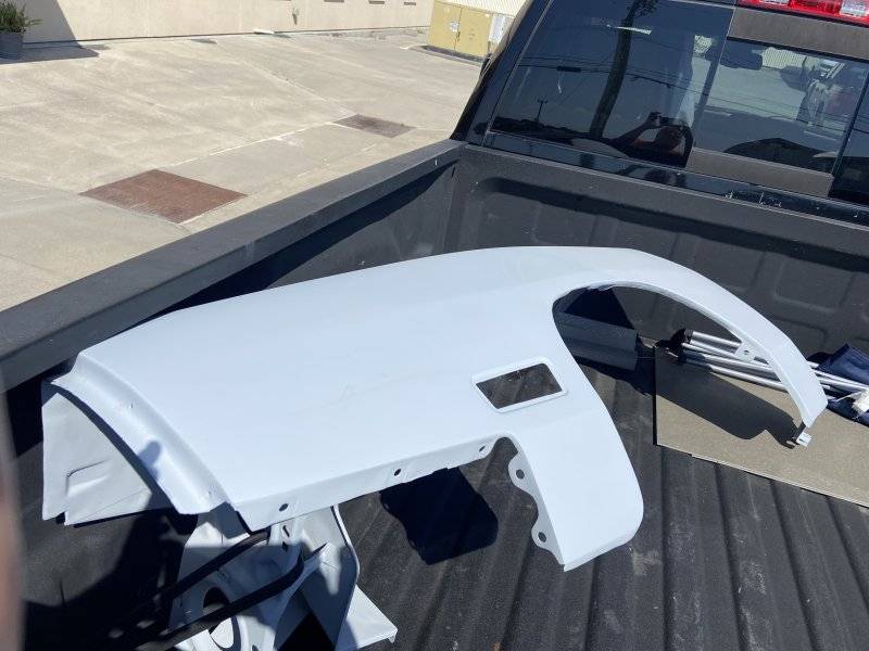

That helps - I took a pic of the distance of the marker from the wheel well. Looking at those pictures and the AMD shots of the 68-69 fenders (inside brackets) I got it.
Thanks again

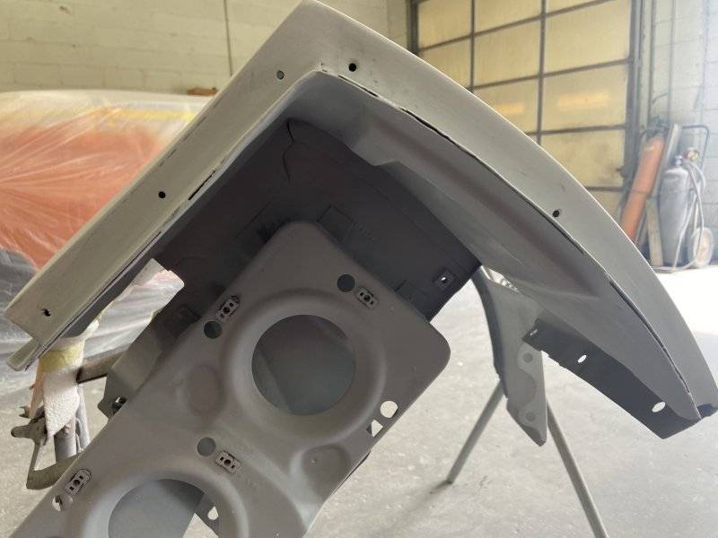

this pic says it all
'68 = round marker light/finished exposed flush front edge
'69 = rectangular marker light/finished exposed flush front edge
'70 = rectangular marker light/inset pinch-welded hidden front edge
