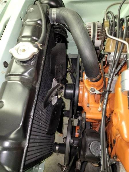

There’s no shroud. I’m not sure what thermostat it is but I’m pretty sure it’s been replaced because I can see fresh gasket sealer under the hose nozzle (I know, I should have replaced it anyway…) and it’s a 4 blade fan.
Holy crap that radiator is ready to go into the fan. The missing Shroud is one of your bigger problems at low speeds.

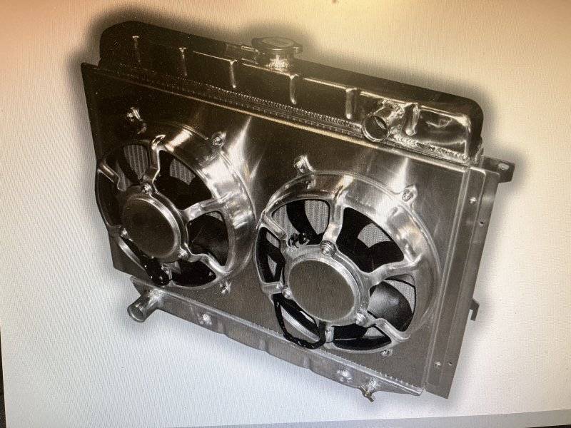

Love my ECP radiator. Solved my overheating issues. Worth every penny. Also changed my thermostat to 180* one. These fans are the real deal
What's wrong with a 4 blade fan, 22" radiator, and no shroud? Mine can idle in 100 degree heat all day long and never exceed 185 degrees. A clean engine, and a quality radiator, with proper cooling components are the keys.
That doesn't look like a 4 blade fan to me @Jerry Hall :fool:

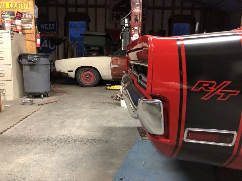

I have their 26" radiators in both of these cars:
I have shrouds in both too along with 7 blade clutch fans.
These do not overheat. I've had the red car in 110 degree weather and it hasn't gone over 200-210.

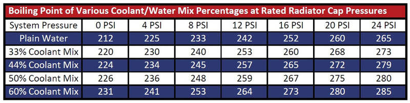

By the way, 220 isn't a problem if you have a mix of water and anti freeze and a pressurized radiator cap. See the chart below:
A typical 16 lb cap and a 50/50 coolant mix boils over at 267 degrees. If you're at 220, you were still 47 degrees under the limit.
