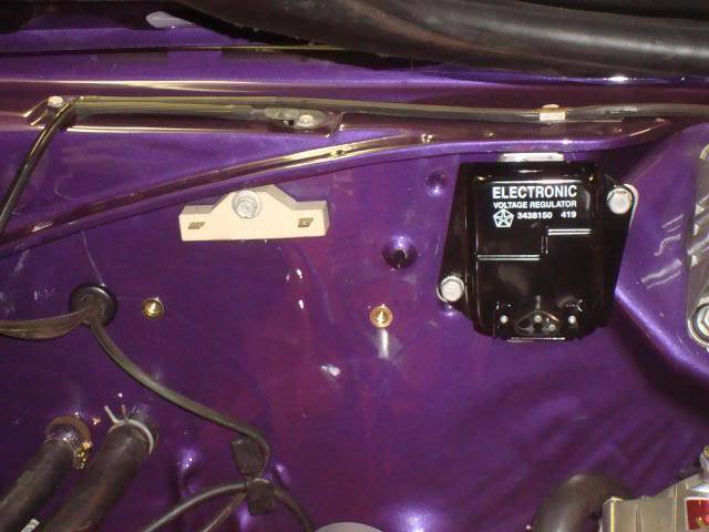

I put mine on the passenger fender well just below the windshield washer bottle

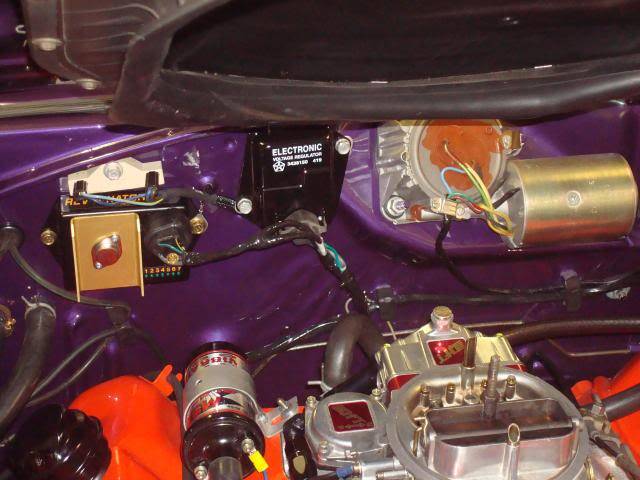

68 RR mine a CEI MP Chrome box, is on the firewall, by the new 4pin 73 & latter Ballast resister & now also the 73 & latter Electronic Regulator locations that are the same areas, as the stock 1968 2 pin ballast & analog regulators

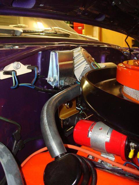

Another view - '70 GTX - still not available factory fitted in this year either...however it looks tidy there. :)

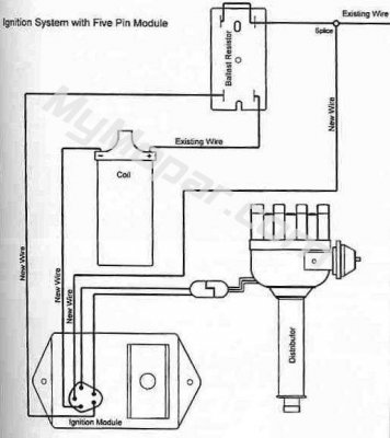

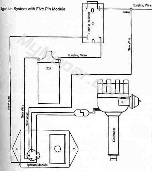

  • Chrysler Elec. Ign. wire diagram #1 4 pin Ballast & electronic regulator #12.jpg

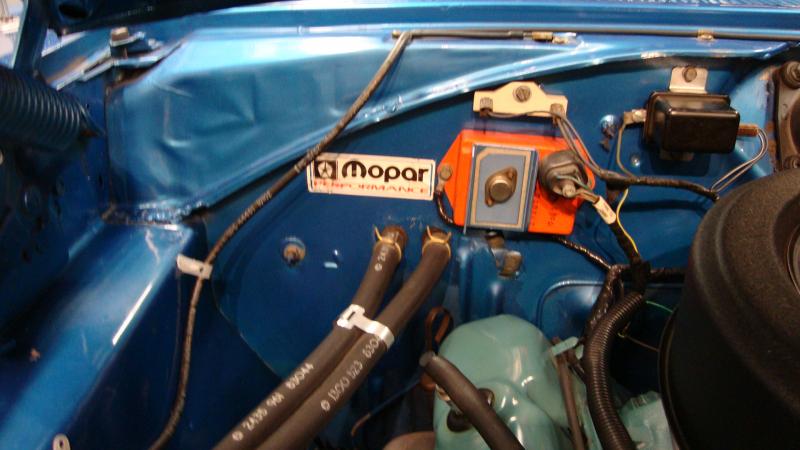

my car came with the "orange box" already installed on the firewall and i actually like the job they did. and im one of those "****" MoPar guys. lol

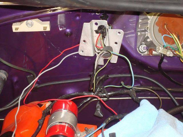

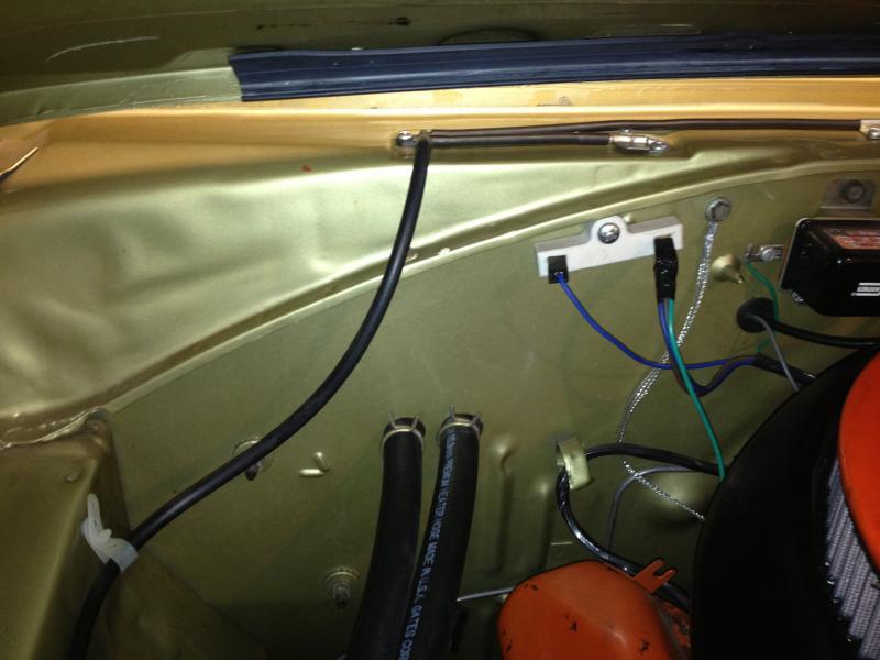

This is where I started out a few years ago by using a hole behind the Voltage Regulator that a previous owner had made. My MoPar boxes were stuck to the top of the heater box using Velcro adhesive squares. Hides the wiring nicely, but a PITA when problems need to be solved.
Fastforward to March this year, and i installed my Rev-n-nator. Tried to run in stealth mode to avoid the extra holes in the firewall....
trouble is, that I felt that the bracket I had constructed might have been vibrating on the firewall - grounding was fine, I just wanted it firm on the steelwork. So I eventually did this a few weeks ago...
rewired with a new Mopar ECU loom...
and I am happy with that. It actually looks like it was meant to be there. Hope that helps somewhat.
