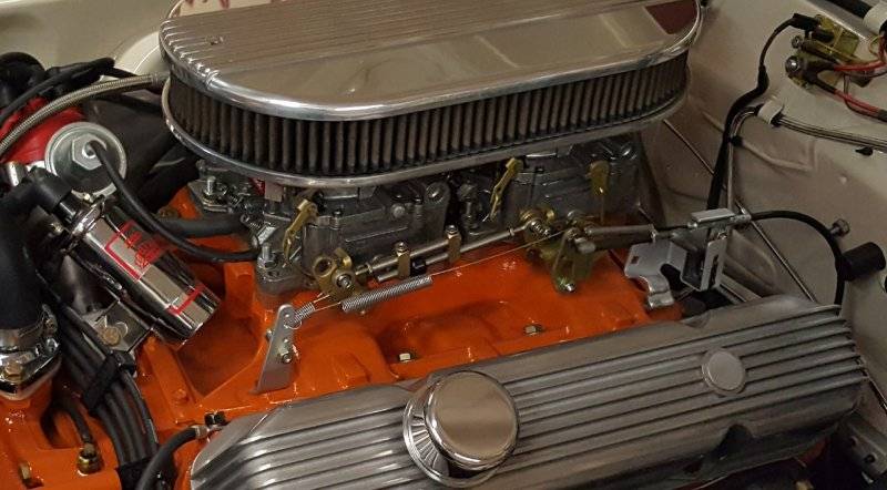

I used the progressive linkage on a gen 2 hemi that I just use for the street. I used a 1406 and a 1405 carb and was very happy with it. I don't race, can't afford to break Hemi parts.
I used factory progressive linkage on the 2 X 4 setup I had on my 426 Street Wedge. 1962 Chrysler 300H induction system; I think the carbs were 450 cfm. each. It worked fine. The linkage attachment point on the front (secondary) carb is higher than that on the rear (primary) carb. This causes the front carb to open faster, to "catch up" to the rear carb at wide open throttle. The carbs on a 426 Street Hemi operate the same way.

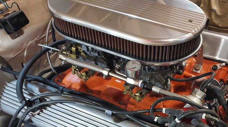

Edelbrock #7094 linkage
Edelbrock 8091 fuel line

I ran a dual 1407 (750's) on a street Hemi with an Edelbrock progressive linkage. With some tweaking and tuning of the carbs, the car ran awesome for years.

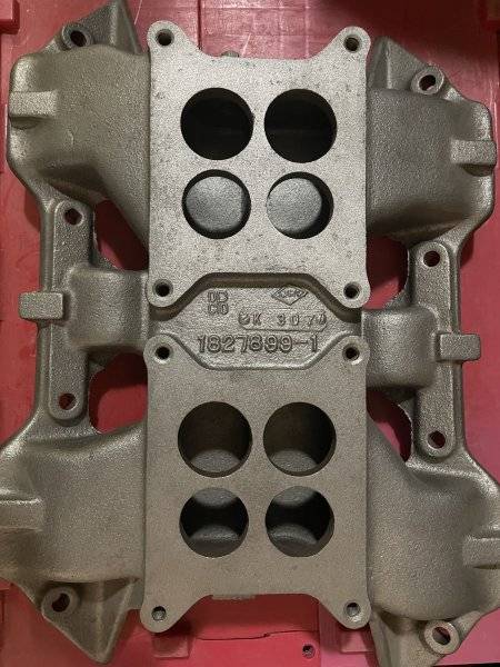

may not be what anyone wants to hear, but i'd sell the iron intake to a collector or restorer and get a ch28. the ch28 is a very good street intake with a nice broad torque band. very easy tune with the edlbrock 600's. maybe the best and least troublesome intake/carb combo i've ever used.

The question I have is how did the factory set the carbs up to run progressive. I originally set mine up to run progressive and the front four cylinders ran lean as all get out. Like 200* hotter than they should. Nice thing about the Eldebrock progressive linkage is you can lock it in for one to one. That's the way I'm running it without any problems. It must be the partition in the cast iron manifold.

I had to open up the primaries in the manifold in order to have the Edelbrock throttle plates pass through them.
