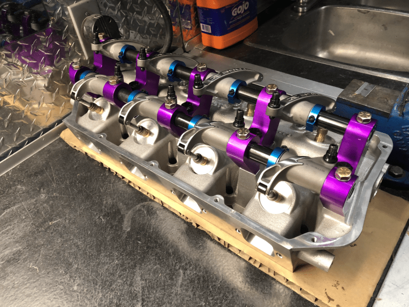

I used the Edelbrock Victor Jrs with Stage V rockers on a KB alloy 4.5” bore. Steam holes needed relocating and the head stud holes reamed. All clear sailing after that.
