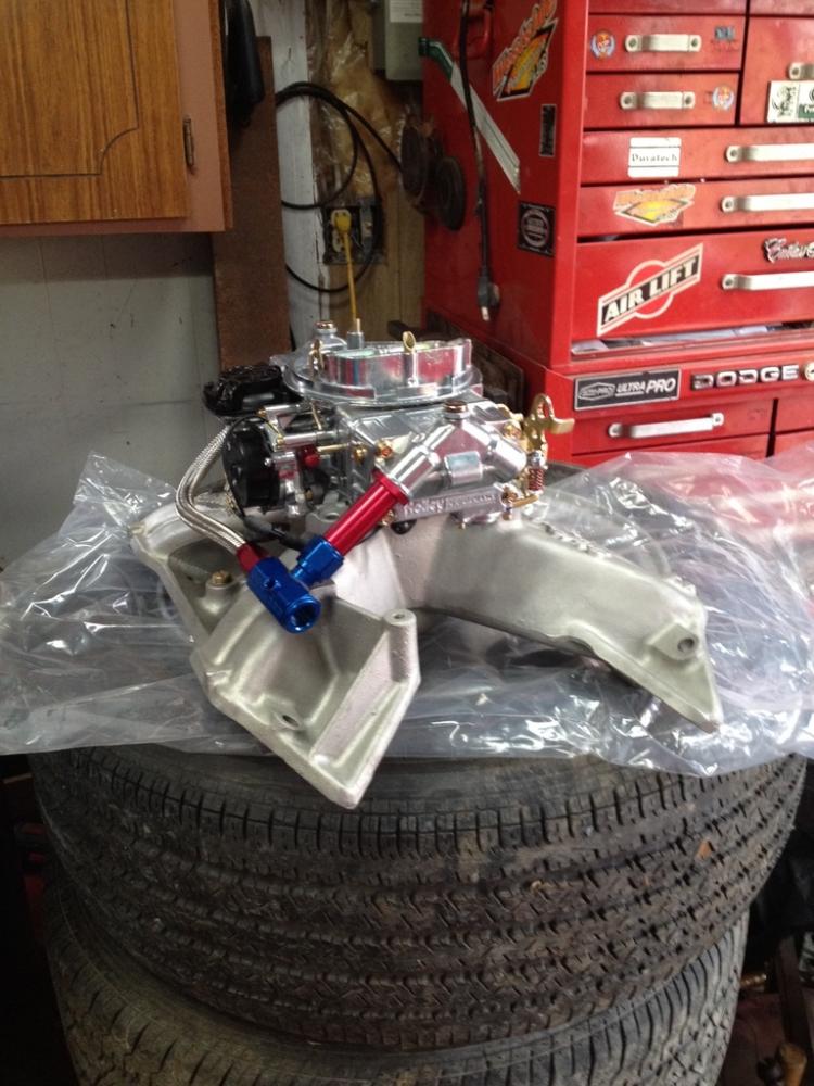

I have a edelbrock TM-7 here I had kicking around. I was wondering if anybody knows if it will fit with my 440 and a bulge hood? Just wanted to switch it up from the edelbrock performer. Also any idea what air cleaner I'd have to run with this intake manifold as well?

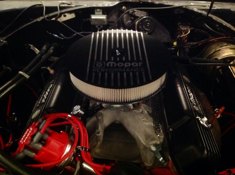

I've got a TM-6 on my 383. I don't think there is much difference in the two except engine. Mine is on a 69 Charger with a regular hood and fits fine. Here's what I have currently. I did switch out air cleaners from a K&N to the mopar.

I just thought and should add..I don't think however, there would be extra room for a carb spacer, at least in my application. If you have more space under your hood, a spacer would probably fit if you run one.
Thanks for the replies fellas, I appreciate it. I measured it up and it's actually not much bigger if it even is bigger than the performer.
