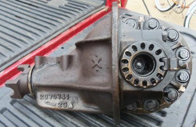

car came with a 318 poly , 727 pushbutton going to a open rear 8 3/4. has the tapered axles. so what info do i need to determine to get a working suregrip in it? suggested gearing . i have a mild built 440 and a b/b 727(pushbutton) and drive shaft out of a 65 cornet that is rebuilt with a stage III transgo shift kit. primary use will be commuting as a hooligan to work (7 miles and 11 stop lights) and occasional highway. no strip . gas and tire economy not a concern...

Yes i am vested in the tapered rear , doing the conversion written up be member Centerline(big thanks). Just need to take 'em to my buds shop and press out the old , seperate , and put in the new . rebuilt the brakes yesterday. So i would rather not scrap the time and $ invested in this set up. Back to the question at hand, what sure grip unit will work with what i got? There is one from a 64 on fleabay. Just waiting on a answer from the seller if the car had tapered axles and if he also has the axles. auction #290821419599. ends tonight... Anyone able to shed more light before i drop more $$. not finding much info on cutting the axles down. three googles down .

Well, that one doesn't have the thrust pin in the center.....which is pretty common in the clutch type SG's. Also, the ring gear is pitted. It could be ok but on the other hand, it might not be. I've run em before that looked that bad and they were ok. Generally, pitting occurs when it's been sitting in a junk yard for years and the oil drains off the top half and moisture takes over.
