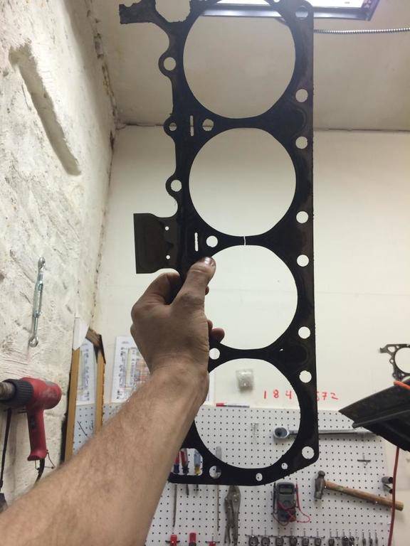

Decided to pull the other head since I bought a pair of gaskets anyway. Low and behold THAT one had a blown gasket, in the same place as the other side!
The crack between #3 and #5 is smaller than the blow-out between #4 and #6, but still, DEFINITELY a hole!
again, here is the gasket from the passenger side:

Do the heads look pretty decent? Anything i should do to them? Any ideas why the gaskets blew like that?
From the pictures the heads look rough. It can do damage to the head and/or block when it blows between cylinders like that. The need to be cleaned up and make sure the surfaces are ok.

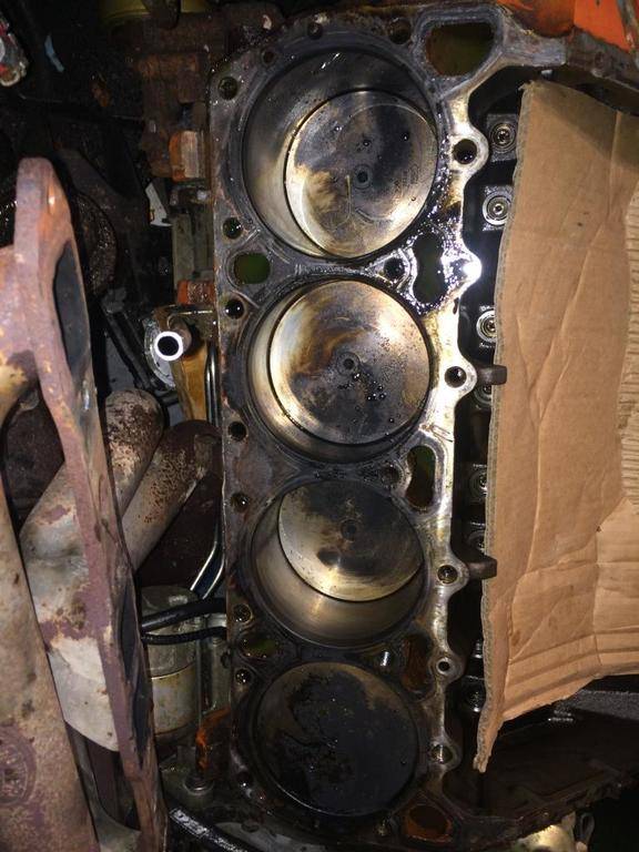

Should I clean off the carbon on the pistons?
Here are some pics:
Driver's side:
Passenger side:
Even though your pistons don't show a lot of carbon build up if it were my engine I'd clean them, but I tend to be a clean freak when it comes to things like this. As I'm sure you know, when you clean the piston tops and the block surfaces you'll want to keep as much debris out of the cylinders, water jackets, etc. as possible. Since your engine is still in the car and not on an engine stand it makes this tougher to do.
