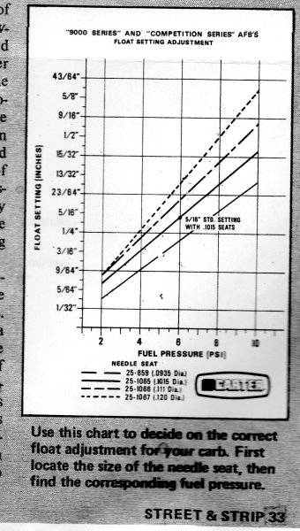

This FALSE information about fuel pressure keeps recurring. The Carter/Edel carbs can withstand 10 psi of fuel pressure. The float level has to be adjusted for the fuel pressure.....on any carb.
My experience with these carbs [ a lot ] is that they are not very sensitive to pressure or f/level. What do you think is happening to the fuel level when the car is moving, cornering etc & fuel is sloshing around??
Float level on Edel is 7/16", different to Carter. So check the level.
