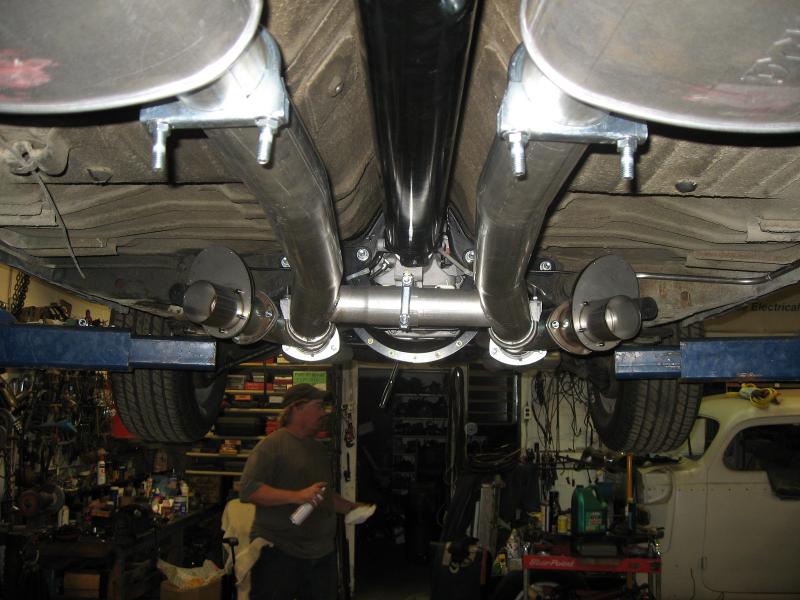

QTP's. Quick Time Performance. 7 years of flawless performance.
Those QTP's look nice... and they make them in 4" as well.
Nice Pipes !!!
