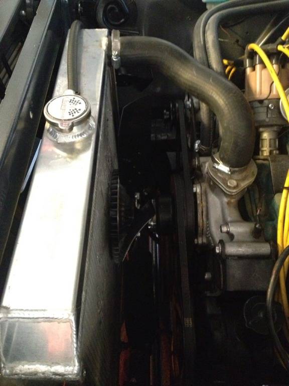

I just installed the Hayden 2765 clutch and the hayden 3619 clutch fan (19"). The clutch is off of a jaguar but is a popular swap to improve clearance. It's 2.67" tall and the fan does not extend out past the face of the clutch toward the rad... in fact, it sits right about 3/4" back away from the face of the clutch.

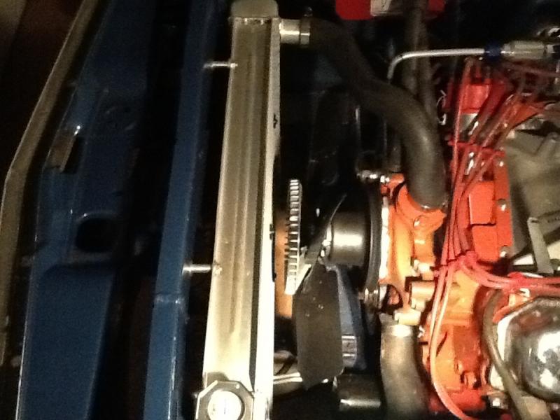

Update..Once I got the electric fans off I decided to try a fan clutch. It is very close I have approx. 3/8" clearance between the radiator and the clutch. The fan has plenty of room.
Without a fan shroud it runs cooler at low speeds then it did with the electric fans. At highway speed it is about the same as the electric. It seems the only thing I gave up is sitting on the side of the highway waiting on tow trucks.
The amp gauge is happy too its not pegging the charge.

Looks like maybe you are running the oem style clutch (hard to tell). If you want more clearance try the hayden 2765 thermal clutch - according to the hayden catalog, it'll give you an extra 0.93" of clearance. Though be warned, because the clutch is shorter it is a heck of a job getting those water pump bolts in lol.

It's a popular upgrade for all old mopars that have clearance issues due to new thicker radiators, etc, as it fits the stock mopar fan bolt pattern as well as the wp pilot and bolt pattern. my pic above shows the jag clutch in my 69 belvedere. it gives me about 3/4ths of an inch (if i recall) between clutch and rad, whereas i wouldn't have the room to even fit the stock size clutch.
