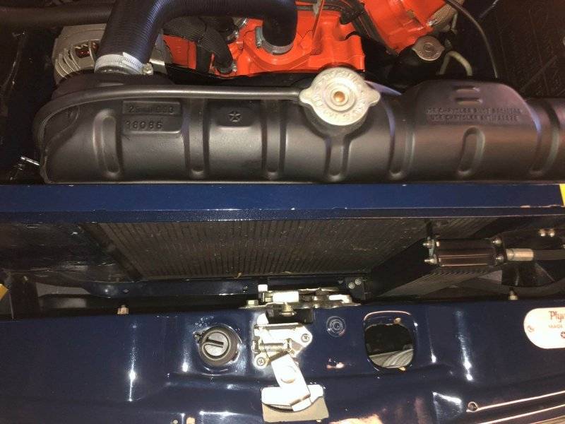

Hopefully the pics below show what we're working with. The photo from the front just shows the trans cooler on the right-hand side of the rad.

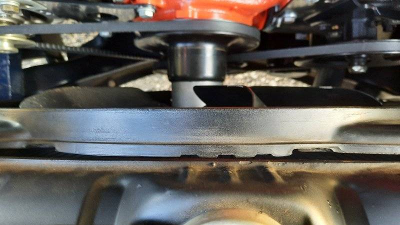

Hard to tell but the fan looks pretty far inside the shroud?
Hi Don, do you mean the depth of the fan inside the shroud? I'll see if i can get a measurement this evening but I think it's about the recommended 'overlap', ie about 1/2 way inside the shroud. Will check tho.
I know the shroud doesn't fit that well where it mounts up against the rad. Its mounting face isn't very flat, so has a few gaps, so as I say, we'll look at replacing it with something better if we can.

The trans cooler is not plumbed ino the rad as our rad doesnt any connections for a trans cooler. It's just mounted there to get max airflow.

Pusher fans just really don't move that much air compared to pullers, but it still may or may not give you just the amount of boost you need. What fan, and if it does the trick, depends on how hot you are getting, how long it needs to run, how it is mounted, etc. The only way to know is to try one out. Pick one with the most flow that will fit your given space. I would consider moving the trans cooler forward if it would help maximize fan coverage of the radiator area.

Fan blade depth should be half in/half our of shroud. Seal the fan shroud to radiator with foam weatherstrip and see what happens. All of the heavy equipment and class 7/8 truck I worked on had the shrouds sealed to the radiator. Inexpensive.

I had a look at the fan / shroud overlap and the back of the fan blades are approx 5/8" behind the back of the shroud. So maybe a bit more than 1/2 way inside the shroud but certainly not fully covered by the shroud...

Move your trans cooler away from the center of the radiator core to allow airflow.
