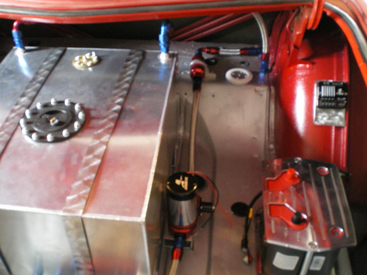

you could go with the Aeromotive setup like mine but will cost you alot more to do it. you better off to go get another holley and rubber mount it
