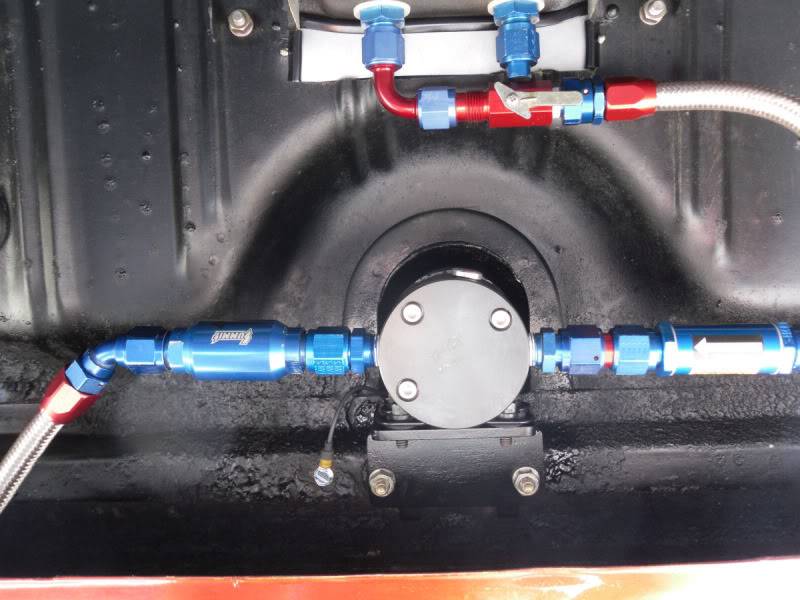

Sooo, my new Hp-150 arrived yesterday and got installed today. It is so much quieter than my old one it's amazing. I suspect that old one was on its last leg for some time.
I did install a more open screening filter (85 micron) on the suction side of the pump and moved my old 40 micron filter to the outlet side. Also put some rubber gromets as washers behind each of the pump mounting bolts. The pump came with a new regulator so i went ahead and installed it too. Here's a shot of the plumbing:
All I need to do not is to figure out how to get a pressure gage that lasts .........
