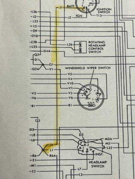

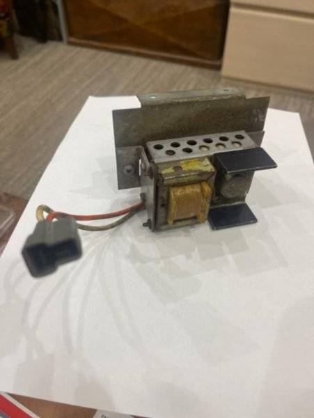

I have a 67 Charger which I am restoring. I have no dash lights when the headlights are on. I have the electrical diagram and have indentified all of the color wires. I have spent hours trying to get the lights to work. I set it aside for the last 6 months and today went at it with my test light to see which wires have power. What I found was interesting:eek:nly 2 wires with male terminals have power. The double pink wires for my glovebox light has power(with the ignition key off) and there is a red wire (see attached photo) with a black male terminal (J1) that comes from the ignition switch ( see attached diagram) that has power when I turn the ignition key. I have no power at the power pack (see attached photo).
My question is this: the electrical diagram shows the red wire conecting to a cluster that has 3 black wires and one yellow ( see highlighted diagram). I am assuming that this red wire will power up everything if I can figure out where to connect it. Does anyone know where I am supposed to connect this red wire so when I trun the enguine on it will power up my power pack and hopefully mi dssh lights?
I look forwrad to anyone's suggestions.
