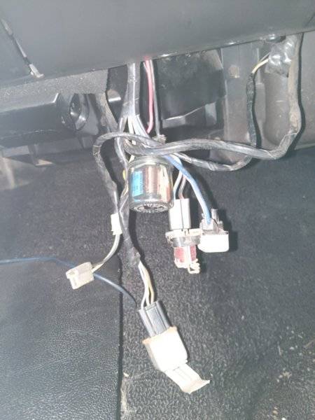

My 71 Roadrunner is having strange issues and strange wires.
First the strange wires.
On the passenger side I have some loose wires thanks to the previous owner. But I cannot place where they are supposed to be or what they are for.
Any thoughts?
