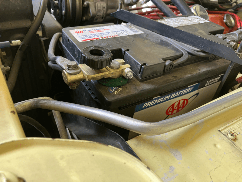

Thanks, but I'm well aware something actually killed that battery through a slow drain over the last month...Glad it was just a dead battery
Aye. The reliable ol' Ram will now fetch Fred a new battery and we'll be taking him out soon.congrats Ed, it's usually something simple......now go for a ride!
So watch where you're going Ed.FWIW The battery taking that final jarring bump could be the cause of it failing, one of the plates could have been weak & that shot could have caused it to fail & internally short out the battery..

Is that an NOS bungee cord?Marine Quality battery cut-off switch. NEVER had a no start. Ever. Even when modern car problems from extended storage.
