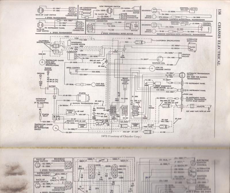

I got looking at schematics this morning and I think the alternator 'Batt' wire may connect to a lot of things. I'll scan and attach the schematic I have for a 1972 Plymouth which should be similar.

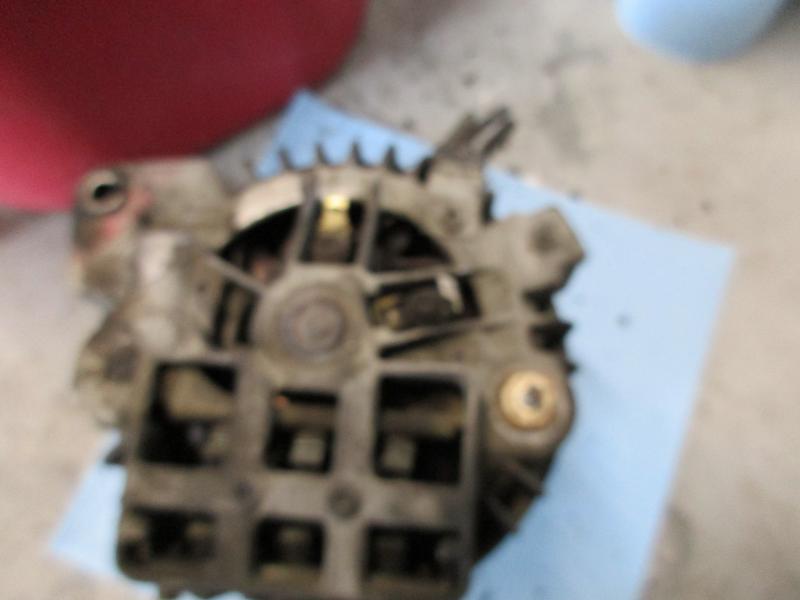

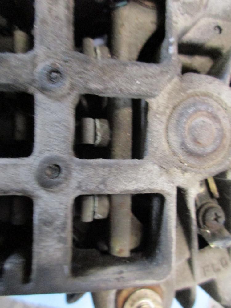

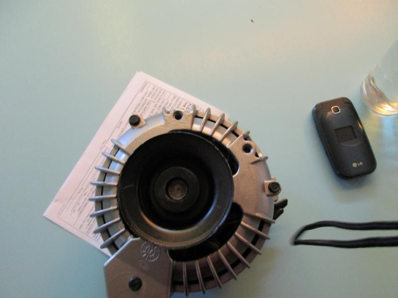

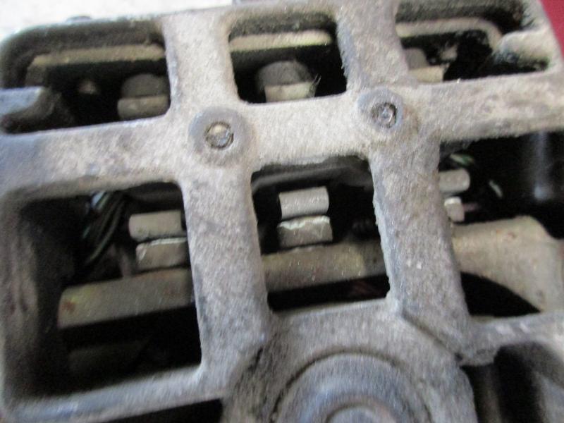

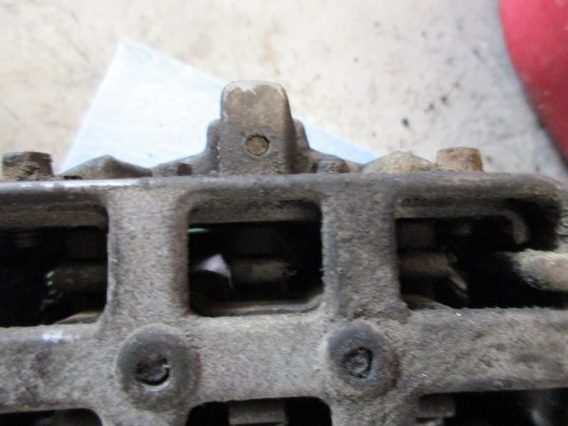

I disconnected the power wire to the ALT and left it off for a couple of days. Hooked it up and the battery maintained 12.5 volts for a couple of days. I turned the key on and off and it drew the battery voltage down to 11.2 volts. Key is off voltage is still dropping in battery. Will remove ALT tomorrow and take it to the electrical repair shop.
Heard from the electric repair shop today Rectifiers are bad A couple of other things were no good also. When I get It back I will try out my new tool.

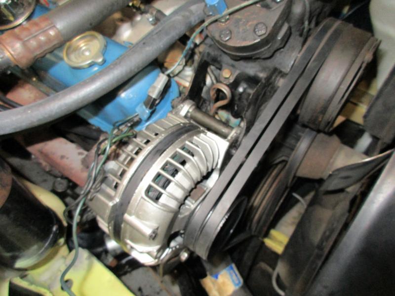

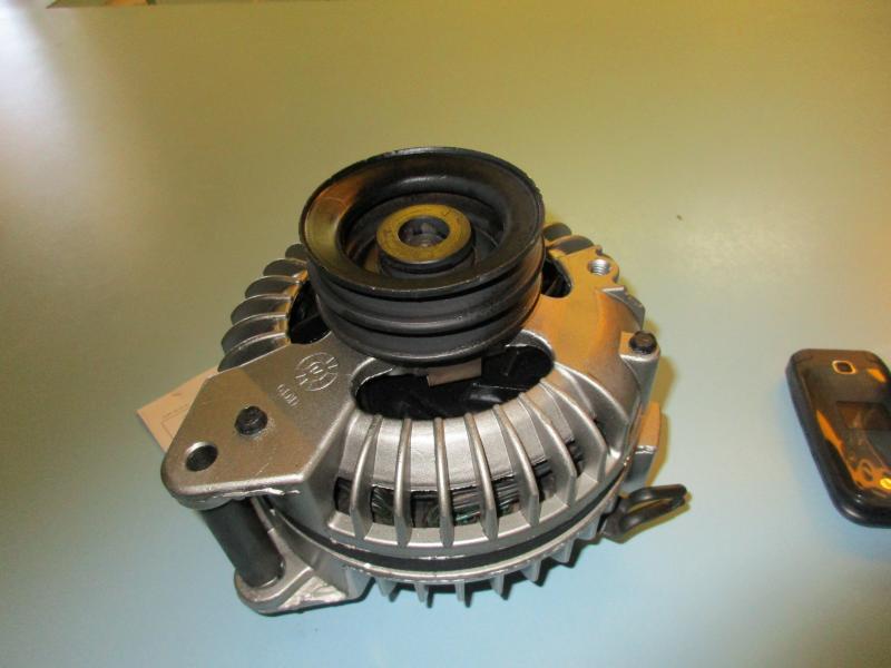

Got Alt back from the electrical shop. Seams to work good now. Drove it around the neighborhood needle stayed between the half line and charge. Tomorrow I will take it out for a longer ride. See if battery maintains charge over night. Thanks guys for the help on this.

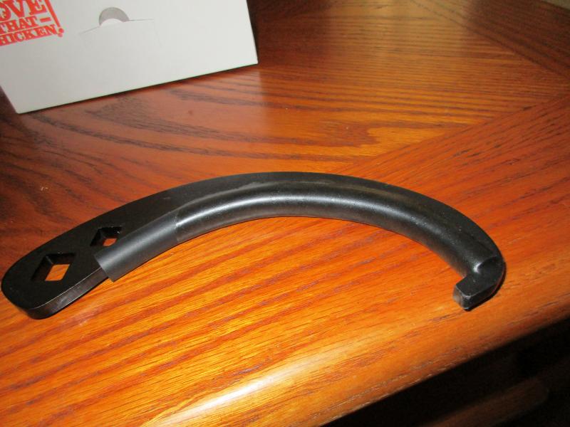

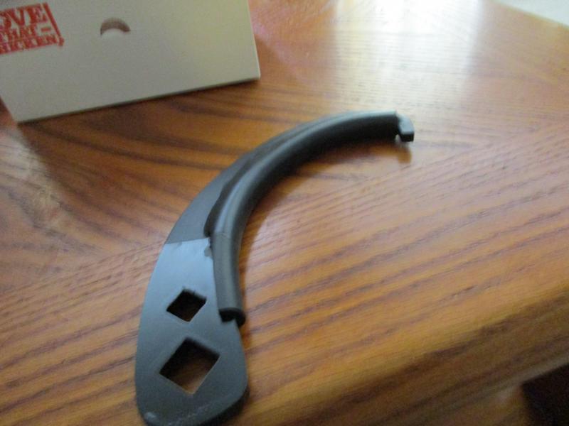

When I would change the belts or have to tighten them up I didn't like prying on the fins. Trying to turn by the alt by hand while tightening the bolts was a pain. The tool just makes it easier.
Granted, you can overtighten the belt very easily with that tool - but I use one every time, myself.
It makes the job of working with fan belts, almost, a joy.
It is one of the best 10$ I’ve spent. My tool looks cruder than his, but will work exactly the same.
