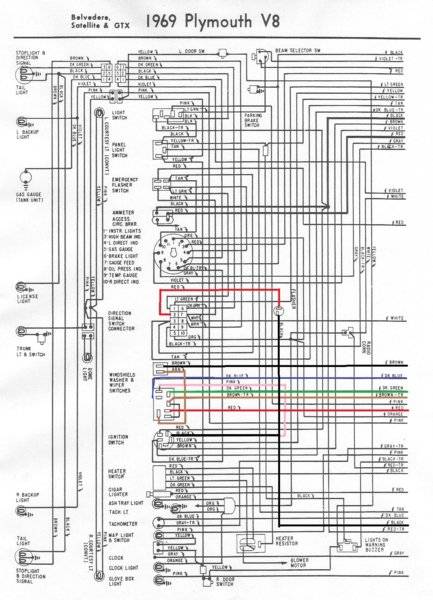

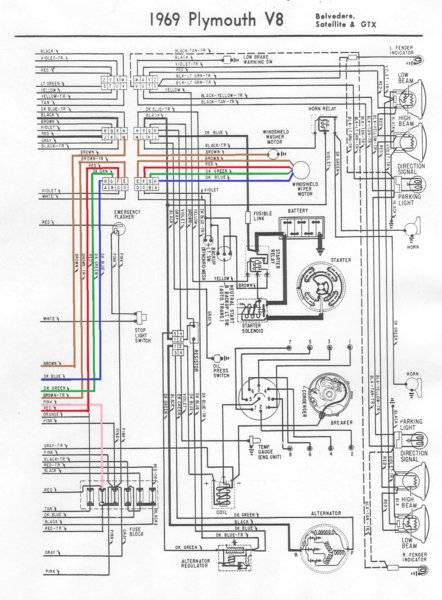

Here ya go check out the schematic I colored in the wiper portion of the harness. You should be able to see where it goes from point A to B. Right click save as..
