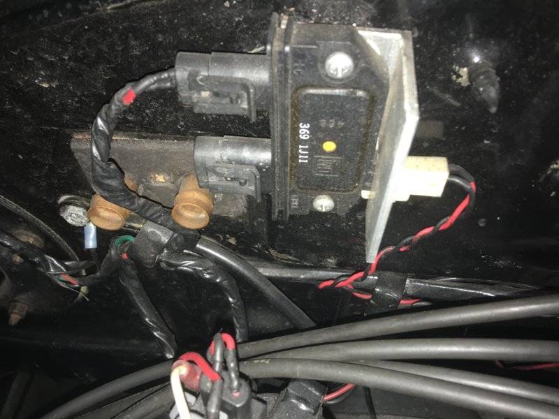

This is what I have on my car. It is not the coil in the cap system.

Buy a good dizzy and do the HEI controller and coil that is NOT IN THE CAP. Those parts are not expensive and available at any parts.

Ok frank, you won me over! I researched it, located all my parts to do the swap, I am just missing one thing. Any ideas where to get a nice solid bracket to mount the FD478 coil to my edelbrock intake manifold?
One thing I did on mine is run the ballast wires to a relay. Pick up 12 volts to feed the relay from the start relay This way you eliminate and voltage drop through bulkhead connector and key switch
