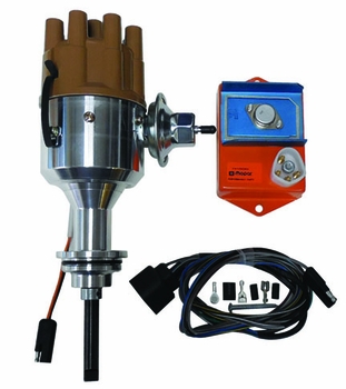

I went with a Firecore distributor along with the standard orange box and MP electronic pigtail on my latest project.

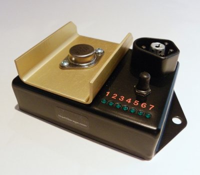

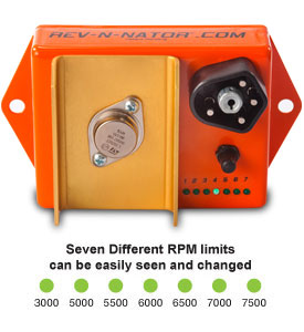

The rev-N-nator boxes www.thertgarage.com are also a plug & play with the CEI style distributors too
also the Mancini Racing kits Firecore or the Mopar Performance packages

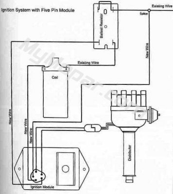

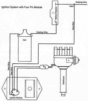

  • Chrysler Electronic Ignition Wire Diagram 4 pin Ballast & Electronic Volt. Regulator.jpg

  • Chrysler Electronic Ignition Wire Diagram 2 Pin Ballast w-4-pin module.jpg
  • Chrysler Electronic Ignition Wire Diagram 4 Pin Ballast w-5-pin module.jpg
  • Chrysler Electronic Ignition CEI-ICU #1 Rev-N-Nator www.thertgarage.com.jpg
  • MRE Mancini Racing firecore electronic distributor conversion kits 361-383-400 MRE90427 $239.jpg
  • MRE Chrysler electronic distributor conversion kits w-orange box 361-383-400 MRE-6993 $199.95.jpg
$165 Firecore Plug and Play distributor and a $40 Orange box. Get 2 Orange boxes and carry one for a spare.
Cheap, simple and easy to tune.
Can't you get a Firecore dist that doesn't need the orange box and ballast res? I might be mistaken but I thought they had one.
Yes you can get a RTR Firecore. I like the idea if (when) the orange box takes a dump you can plug in another and get home. If the module in a Firecore or any other manufactures RTR goes south where are you going to get a replacement?
