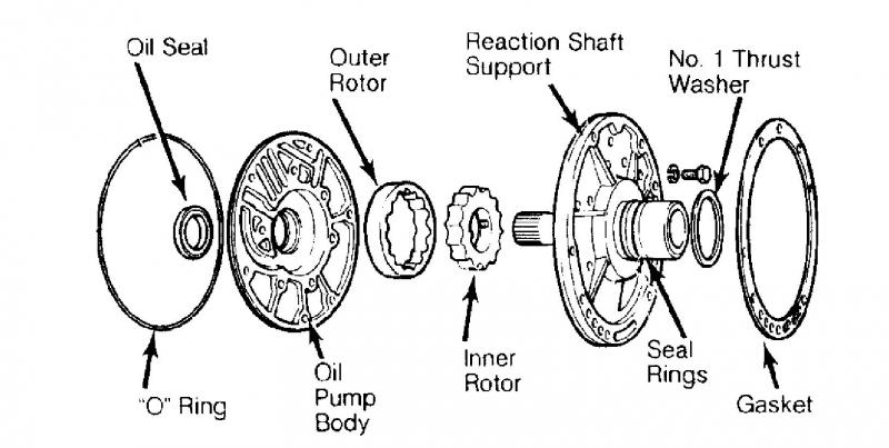

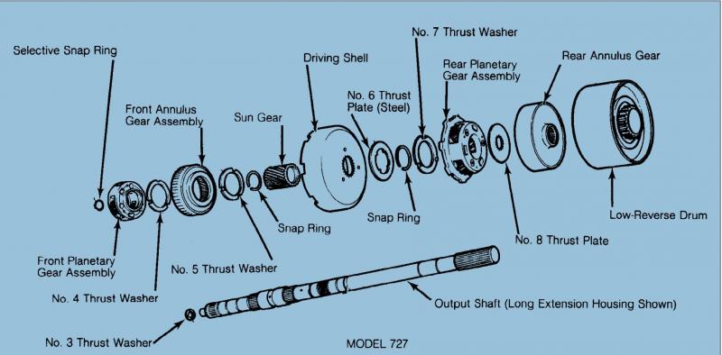

You may have a washer in the wrong place.
Did you remove the bearing completely? May put back on backwards?

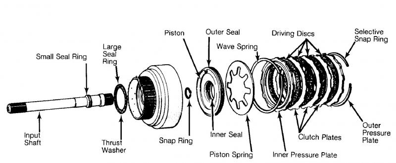

Pull the pump and make sure the forward clutch and direct clutch are seated all the way. If they aren't, when you bolt the pump down it smashes all together

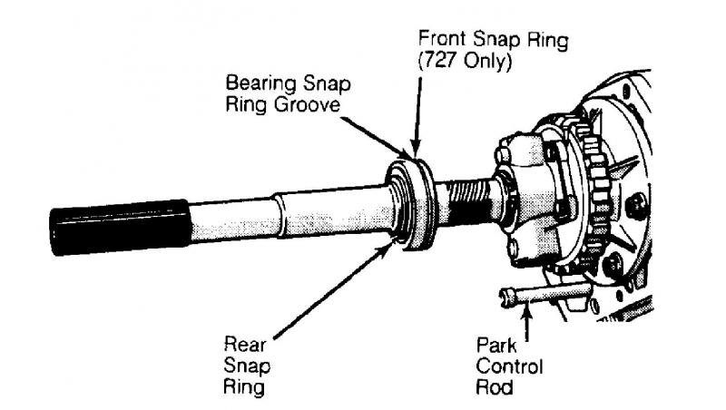

Also make sure when tailshaft is installed, that the bearing is fully seated and its snap-ring is all the way in the groove.
Pulled the pump back off again and installed it for the last time. I must have been careless the first time and squished some of the hubs/clutches together. Seem to be fine now, the tailshaft and output section are all in order as well. Hopefully i can get it back behind the 440 before too long.
