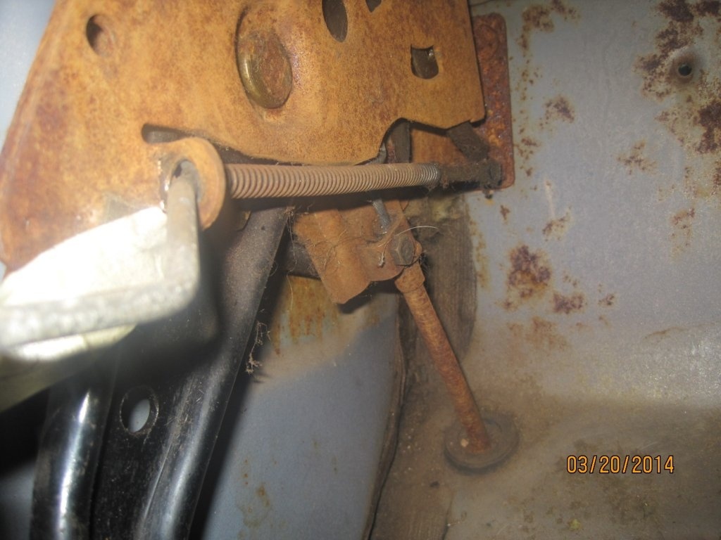

Hello Friends! This is Wild Bill. I had a question as to how to install the emergency brake cable to the interior E brakepedal mechanism. Does anybody have a photograph on what an install looks like. And, if possible what parts are needed to complete this install. Lesson Learned: I did take photos of the E Brake Pedal Mech before removing it from the car. To further complicate matters I was not to diligent in cateloging the removed parts, or if they were such was lost when those parts were cleaned and restored. Update: will put my 1969 Road Runner on the road (spring) for the 1st time after an eight yr restoration. Here We Go!!! Iam as far as I can go and now must test drive to find any remaining "bugs". Everyone has been so helpful on this site. I could not have gotten this far w/out all the help of the mopar family. Thank you so much!

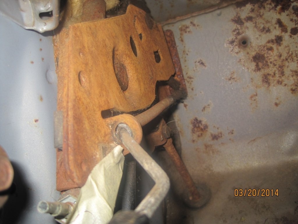

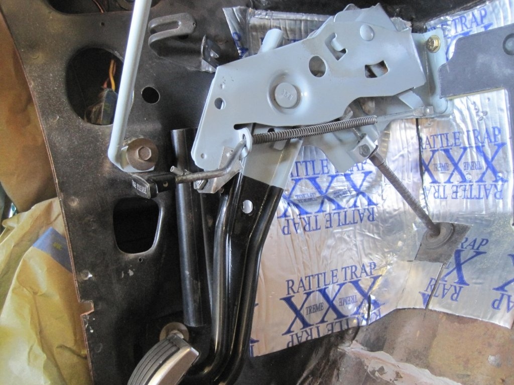

Bill,
There's only one picture post-resto and a couple pre-resto. You can see the E brake cable attachment; didn't take any pics of how the cable attached inside the mechanism. Hope this helps a little.

Again excellent pics coronetdarter. I see now how the cable is HELD to the e brake mech. thats what i needed to see. thanks
