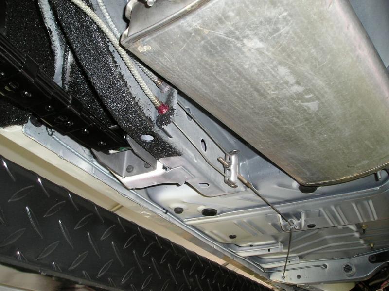

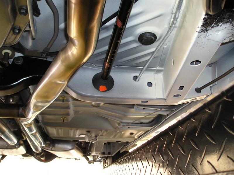

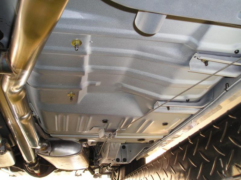

Hi, Got a 68 RR, putting in the emergency brake cable, where does the cable retainer go? What side of the brace? How does it attach and lock to car frame? Mine was missing when I got the car. Thanks Phil
This help any ?
Emergency/Parking the same thing no difference
Thanks for the photo looking to see where the cable retainer goes in the frame brace, Phil
