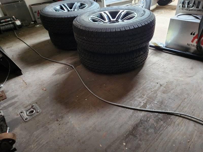

I just used regular ole indoor/outdoor paint. Nothing fancy.

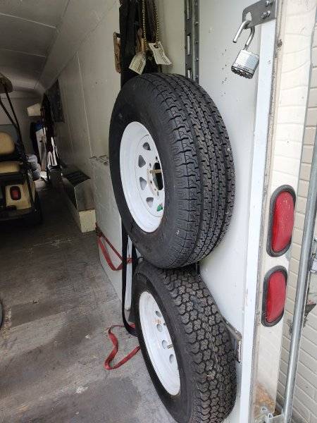

I guess I don't have many photos showing the floor of my trailer. Mine is a 2007 and has held up this long.

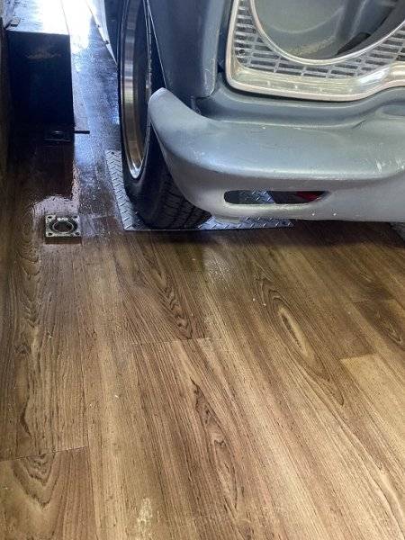

I bought a 97 model 28' in about 02 and it had a vinyl wood grain floor in it. Still there. Oil, water, dirt, etc wipes/sweeps right up. I'll try'n get a pic tomorrow.

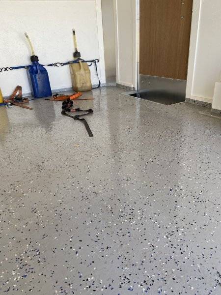

I know you said ideas other than epoxy but I thought I would throw it out there anyway. This is Home Depot, rust-oleum epoxy garage flooring. I was told it wouldn’t work. I primed the floor first then did the epoxy. I used the trailer for 4 years and it looked great when I sold it

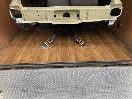

The two enclosed trailers I have both had rolled linoleum floors when I bought them, very low maintenance. One has been as a general purpose utility trailer and the floor gets abused, and it has some tears and bad spots, mainly from dragging large items in and out of it. The other is mainly just used for moving cars and it has held up well. I have to say PrescotJeff's floor looks awesome!! as well as the finished floor of thehemikid's
I know you said ideas other than epoxy but I thought I would throw it out there anyway. This is Home Depot, rust-oleum epoxy garage flooring. I was told it wouldn’t work. I primed the floor first then did the epoxy. I used the trailer for 4 years and it looked great when I sold it View attachment 1871062
