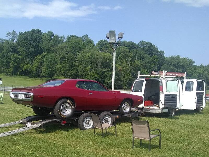

I'm keeping my eye out for a good deal on an enclosed trailer to transport my 73 Charger to the racetrack. This will see regular use during the racing season, so I want to make sure I get one that's easy to load and unload.
As you can see in the pic below, my current trailer is a little on the small size.
A 73 Charger is long and fat, so can anybody tell me what size works well?

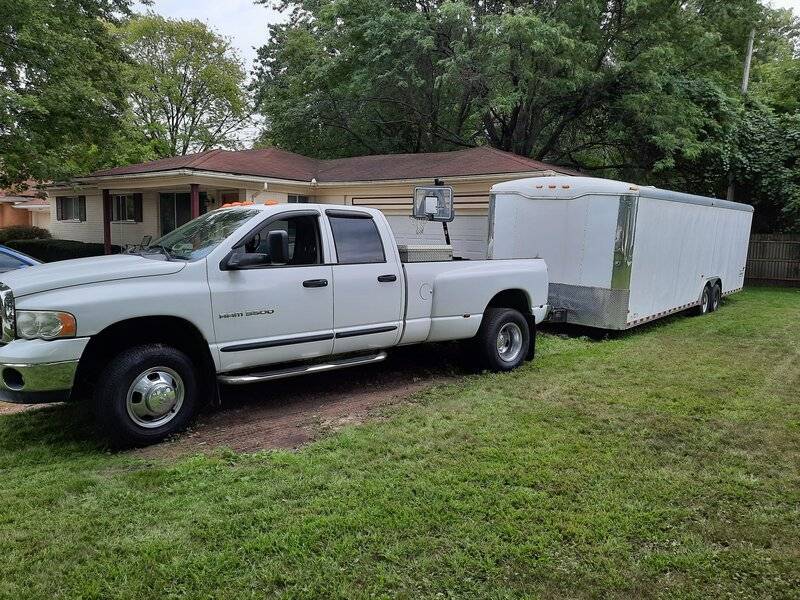

Believe it or not, that's a 1 ton van in the photo. Rides really well, but I don't think it has enough power for an enclosed trailer so I'm looking to upgrade that as well.

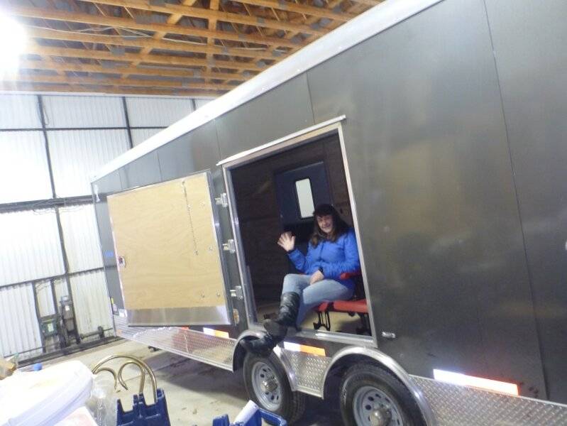

Why is the driver side door so uncommon? Seems like a no brainer for a car hauler.
Cost I suspect. Wouldn't have one without it (at my age).
Not a fan of crawling out of the window or sliding out the door gap at my size !
Gotta have the kissing booth window....

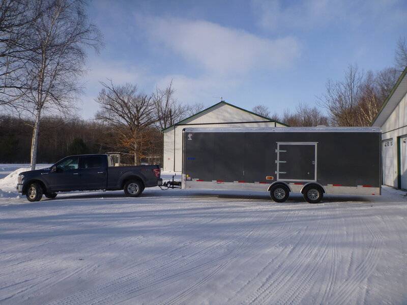

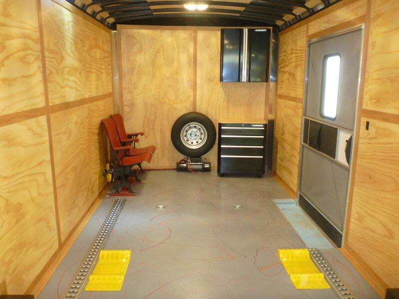

24' with spread axle, you won't even know it's behind you. No "bucking" in the cab...

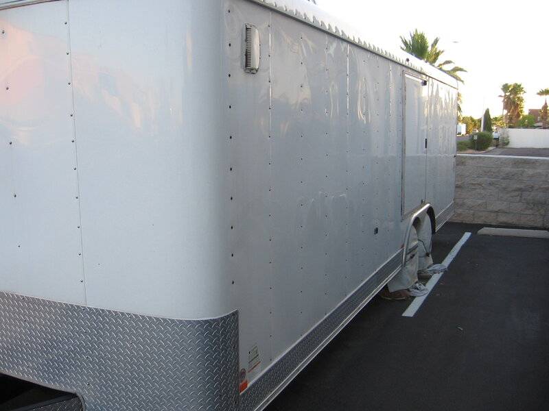

I have a 28' trailer. The 71 Charger fits fine with plenty of room. Trailer had cabinets/workbench up front, and likely 4 ft or more from front of cat to cabinets.
I think around 2 ft behind the car. The extra space makes it easy to tie down the car to the trailer.
The side escape door allows me to drive the car in and open the car door to get out.
Without the escape door, I think I would have to wench the car in unless you are really skinny and climb out the cars window.
24 ft ideal ....with escape door on driver side .... aluminum is nice but very expensive....will be hard to find used with escape door .....good luck
I bought a used trailer. I have to winch my race car in and out. Harbor Freight winch with a remote, works great.

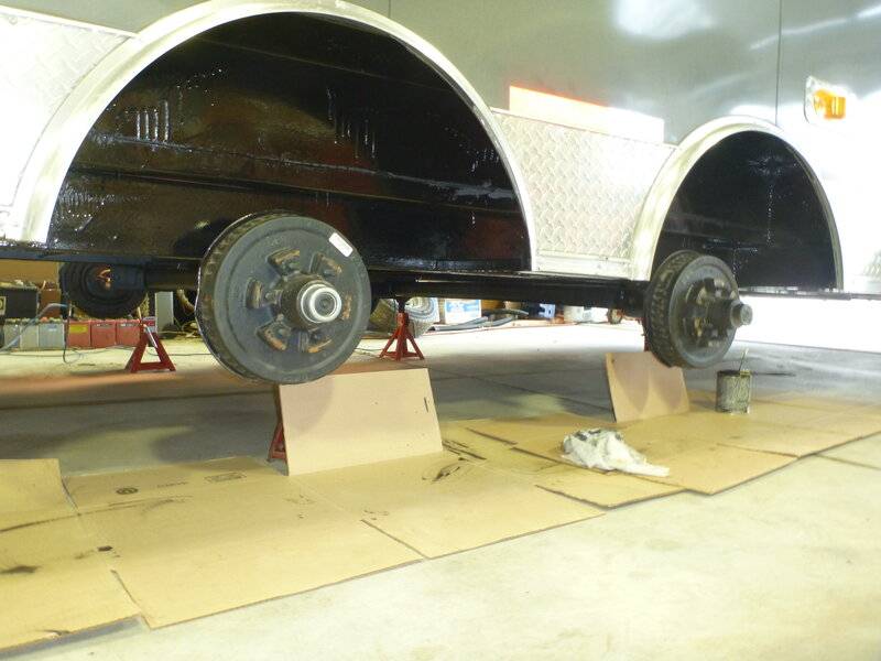

Hey dads bee tell us about the spread axle set up, I’ve never pulled one and yes the bucking gets real old.. I recall going thru Oklahoma in my ram pulling a 24’ empty and it stank! Loaded it was great. What brand of axles do the use ? Can you get those as torsion set up? Thanks !
Not sure what to tell you, they are torsion axles. 6000 lb ones. Trailer manual is out in it, in the tool box, if you want some more info I can get it tomorrow. Trailer is an Atlas..
