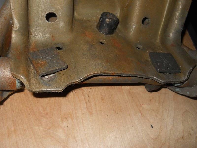

I have what I believe is a NOS 73 up B body right side upper control arm. I don`t see any marking ID numbers so I can not verify for sure of the fit and what side it fits. I no longer have my 73 charger to compare it to. I bought this many years ago and I don`t have any history on it. Anybody know for sure.
I have looked at it better........ and I see a wider area underneath, just down from the ball joint, but also there is a bumper stop already mounted on the upper A frame.
So, not really sure which side it is. Sorry, I couldn't be of more help.

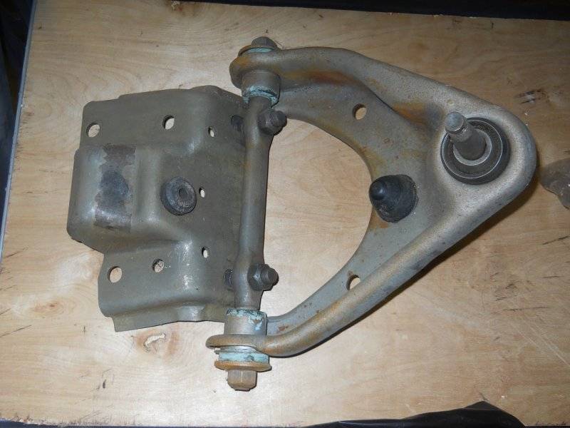

That's a left if the photo is not mirrored.
No not mirrored. I just looked at it in person to make sure. I also was comparing it to online pics on ebay and I believe you are correct. It there any way to verify it is B body . I thought years back I compared to a F body upper( which looks close) and it was a little larger in size.
Yes, F/M/J is very similar if not the same.
The UBJ angle is different from side to side..
Compare to what's on your car.
Found out it is a 73 up B body left side thanks for the help.
