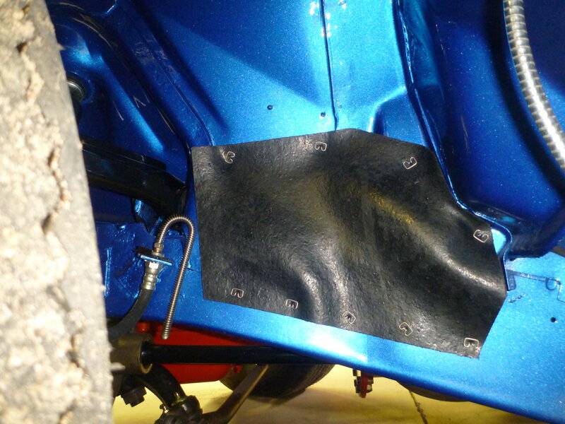

Hey guys, Does anyone reproduce the access panels in back of the front control arm, its metal? I found one on ebay but the screw holes are on the side not the top, mine are on top for my 69 roadrunner 383. It also doesn't look like the correct shape.
Thanks!
Sorry but Joel is correct, front one is metal, rear one is a rubber flap..
Hmm, I wonder what the plate I have goes to. I have the front ones, I will check them when I get home. But that is the one I need in the picture.

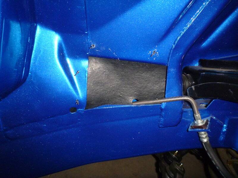

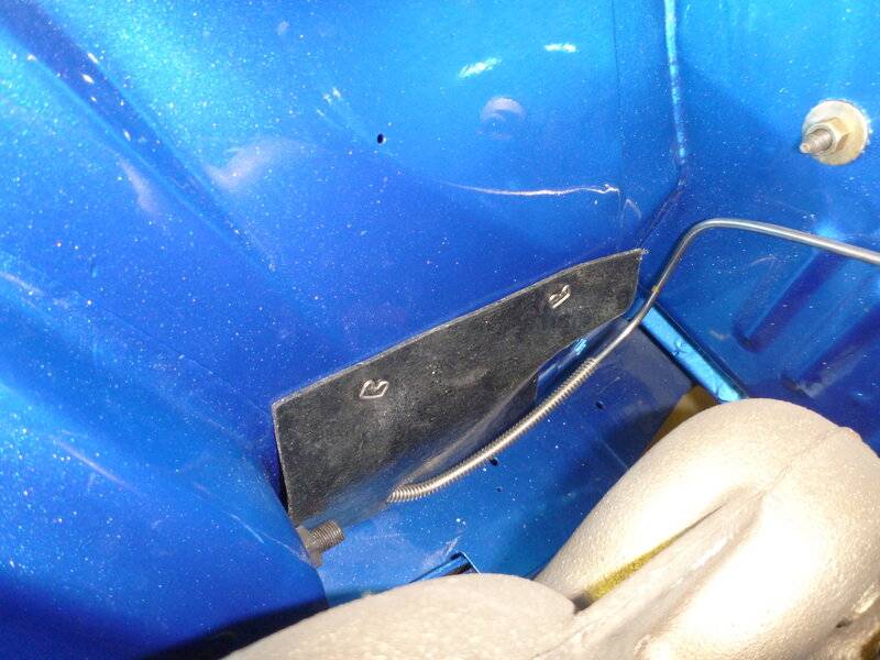

Joel ( @hunt2elk ) above supplied the link to get the correct rubber seal and "staples". Drivers side installs from the outside, passenger side installs from inside the engine compartment.
