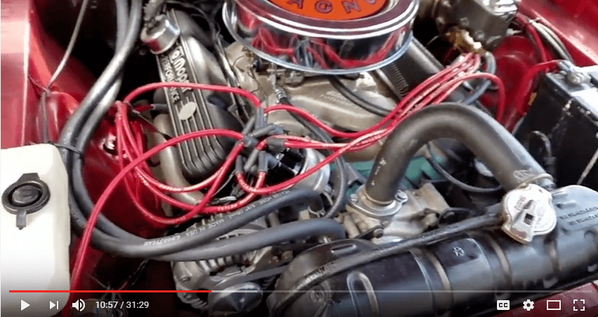

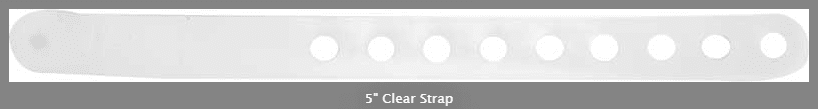

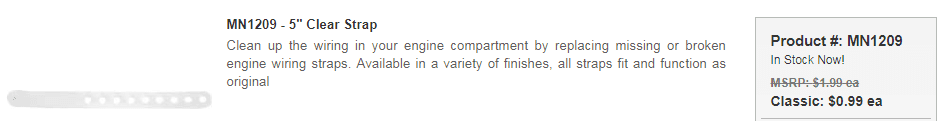

Hey guys. On the passenger side there are 3 clear plastic straps that I need to hold the heater core lines & window washer line to the side of the bay. They plug into the side by the wheel well and you then loop them around & they snap in.
I believe these are the ones but need a 2nd opinion.
Thanks Justin! Looks like I'm missing the valve cover one, correct?

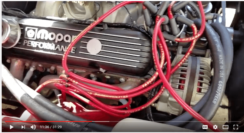

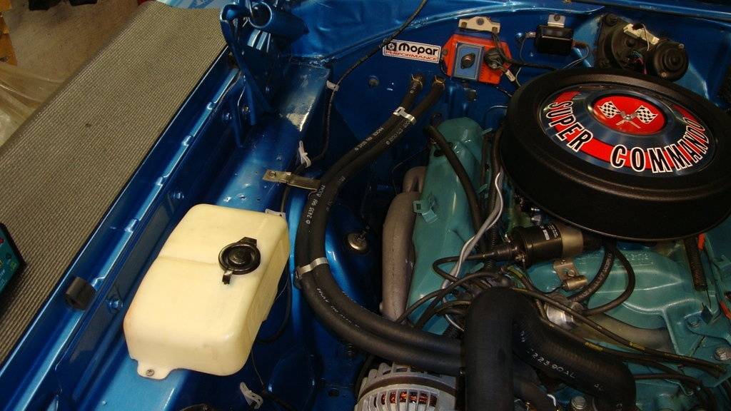

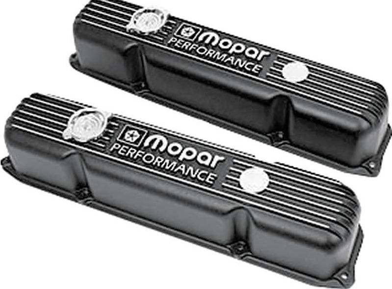

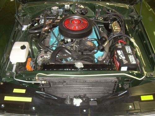

You said your missing the correct valve cover and I said "correct"...The ones you have are aftermarket and do not have the bracket on the passenger cover for the clip to attach. So either you change valve covers or find a better option to hold the heater hoses out of the way...the plastic loom is not a good idea. The 69 inner fender bracket is a good choice with the straps if you do not want to change your valve covers. It is in that same link...
Looks like you have aftermarket valve covers, so no hold down clip for heater hose. I would just go with the hose bracket that 69-70 used, that screws to inner fender.
Thanks guys! Looks like I'll order the alternator bracket.

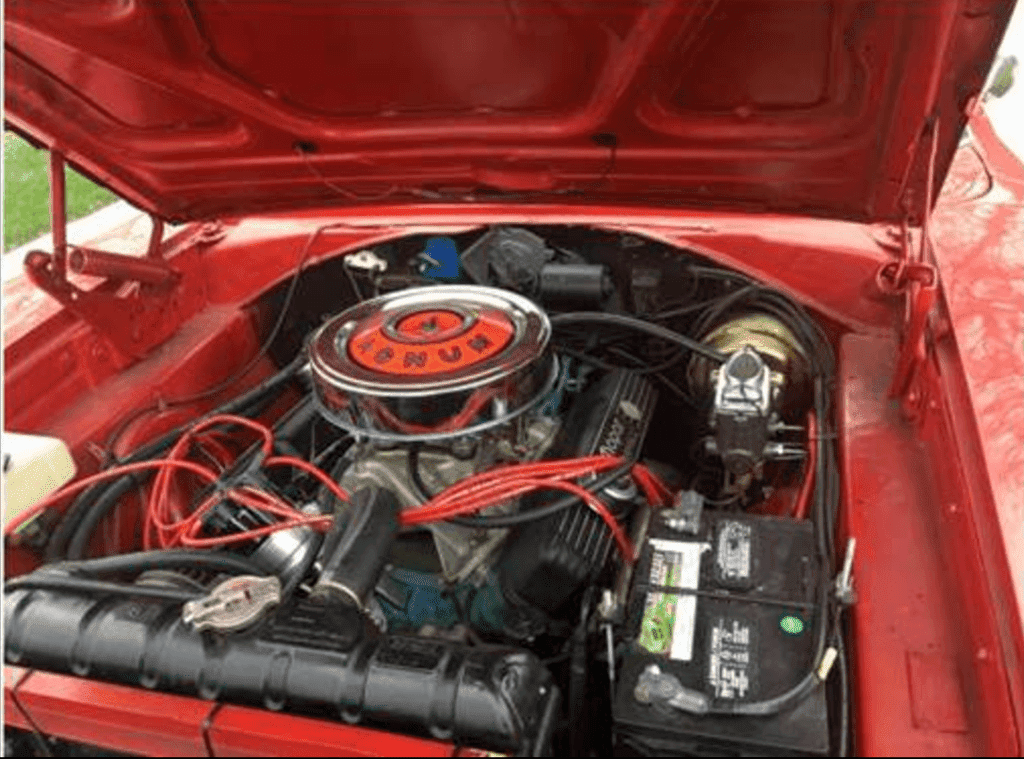

I did the same thing. 69 bracket on my 68 GTX.
if you look at my valve cover, that one is the correct one for a 68. I subsequently changed V/C's to M/T ones, so I needed the 69 bracket
