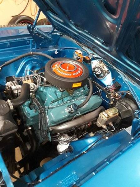

OK, I'll do that and get back. This is just a pic of the engine compartment.

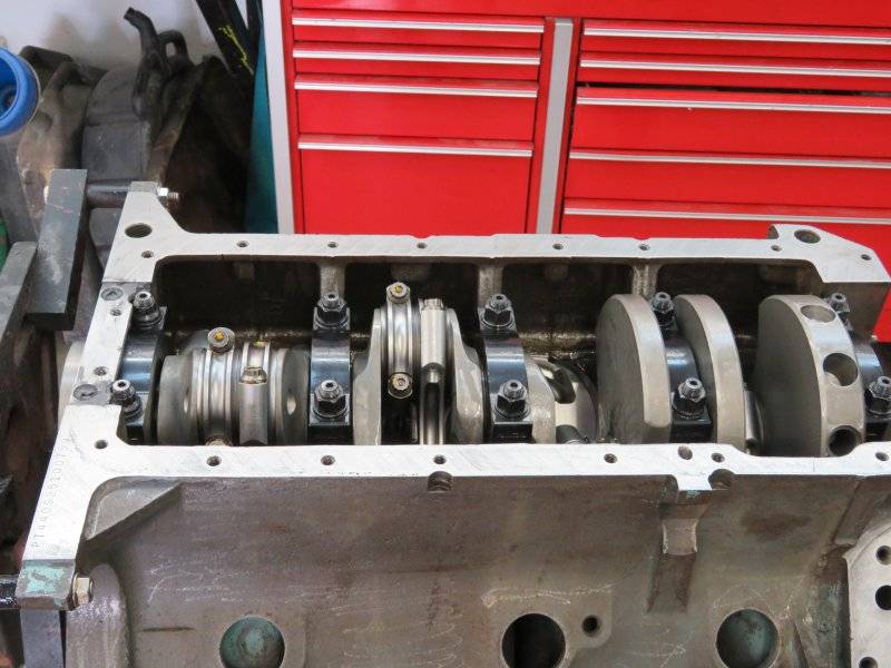

BTW- I have two 318 warranty blocks- one in a 67 and one that was removed from a 73 that has a 76 date.
I haven't dated the one from the 67, but it has the riveted tag below the head.
The 76 block has a blank pan rail pad.
It is on a pallet. Next time I have a spare hour or two, I'll see about the rear flange/ear area.

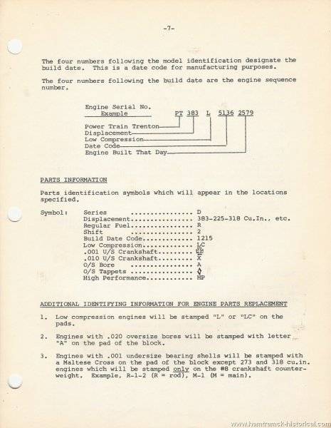

PT 440S25100759
Note - this is the engine serial number, not a VIN of any kind. This alludes to me that it was a complete engine, not just a service block/short block. Being a '68 and a 'performance' engine, there's a good possibility a partial VIN is stamped into the top of the transmission flange next to/in the area near the oil pressure sender.
PT = 'Plant' "Trenton" where the engine was built
440 = displacement
S = "Special Engine" - I believe in '68 that is an "L" 440 375hp for R/T or TNT C-body
2510 = built Tuesday, June 11, 1968
0759 = 759th engine built that day (all displacements I believe)
A copy of two pages of the '68 TSB that relevant - from Hamtramck Historical
