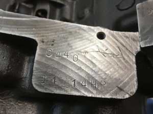

Can anyone decode what this stamping tells me. Block in my 67 GTX that is supposed to be original. Is it? There is supposed to be a stamping by the heater hoses, but if there is, I sure can't see it. If that is a clock or calendar at the bottom, it only has 9 hours or 9 months. I know the D and N is supposed to designate day or night shift.

Can anyone decode what this stamping tells me. Block in my 67 GTX that is supposed to be original. Is it? There is supposed to be a stamping by the heater hoses, but if there is, I sure can't see it. View attachment 534294
There is a flat boss next to the heater hoses. You may have to scrap several layers of pair to see it. It was hand stamped at the factory.

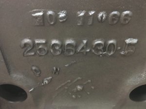

There is also a date cast on the block too. Here's a 67 block and pad picture.
View attachment 534311 View attachment 534312

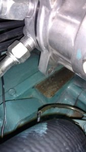

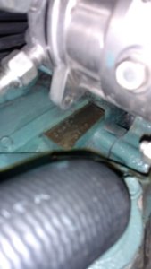

I will have to look again. I have have the date above what I posted and missed it or it was visually blocked by something. Between two temperature gauge sending units, heater hoses, and an electronic ignition module on the outside of the distributor, I see nothing on that side, or even a flat spot to be stamped. Is is visable with the block fully assembled? On a horizontal (top of the block) or vertical (side of the block) surface?
Casting dates are tucked up under the exhaust manifold but you can see it. The pad on the front of the engine should accessible.
The machined surface the assembly date is stamped into is on top of block, in front of intake manifold, maybe under a/c compressor.
Okay! Now looking in the right spot (under AC compressor) scraped off some paint and voila! It says C440 and 8 31 HP. I guess this means August 31st and the car shows as shipped 9/13/66. Is the 8 31 supposed to be the engine build date or the car build date?

I guess I need to crawl back under and see if the block casting under the exhaust manifold says 66. If so, I guess I can assume this is the original block.
View attachment 534865 View attachment 534867
Getting close. Dates line up. No VIN or Julian dates on 67 engines.

Okay! I looked above engine block casting numbers on both side and cannot find a casting date on either side above the casting number. This is an RB block, which is why the engine pad was under the compressor rather than by the distributor. In the engine assembly stamping of C 440 the C indicates 1967. This must mean model year 1967 rather than calendar year the engine was assembled, since the car was shipped 9/13/66. The engine assembly date was 8/31, which had to be calendar year 1966. There is also a small 12 2 separated with a dot disappearing under the starter that is most likely the block date code. It cannot be read without removing the starter.
