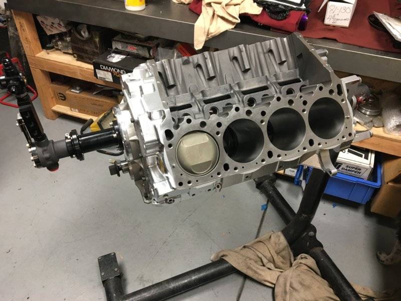

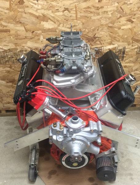

I did this one two years ago with the 240cc trick flows and a big Hydraulic roller cam. It made 680 on the first pull and had a near flat 700ft/lb torque curve. You really don’t need the spray.

I did, lol. I built it for a local guy. It’s in an A-body and runs mid 10’s on pump gas.
