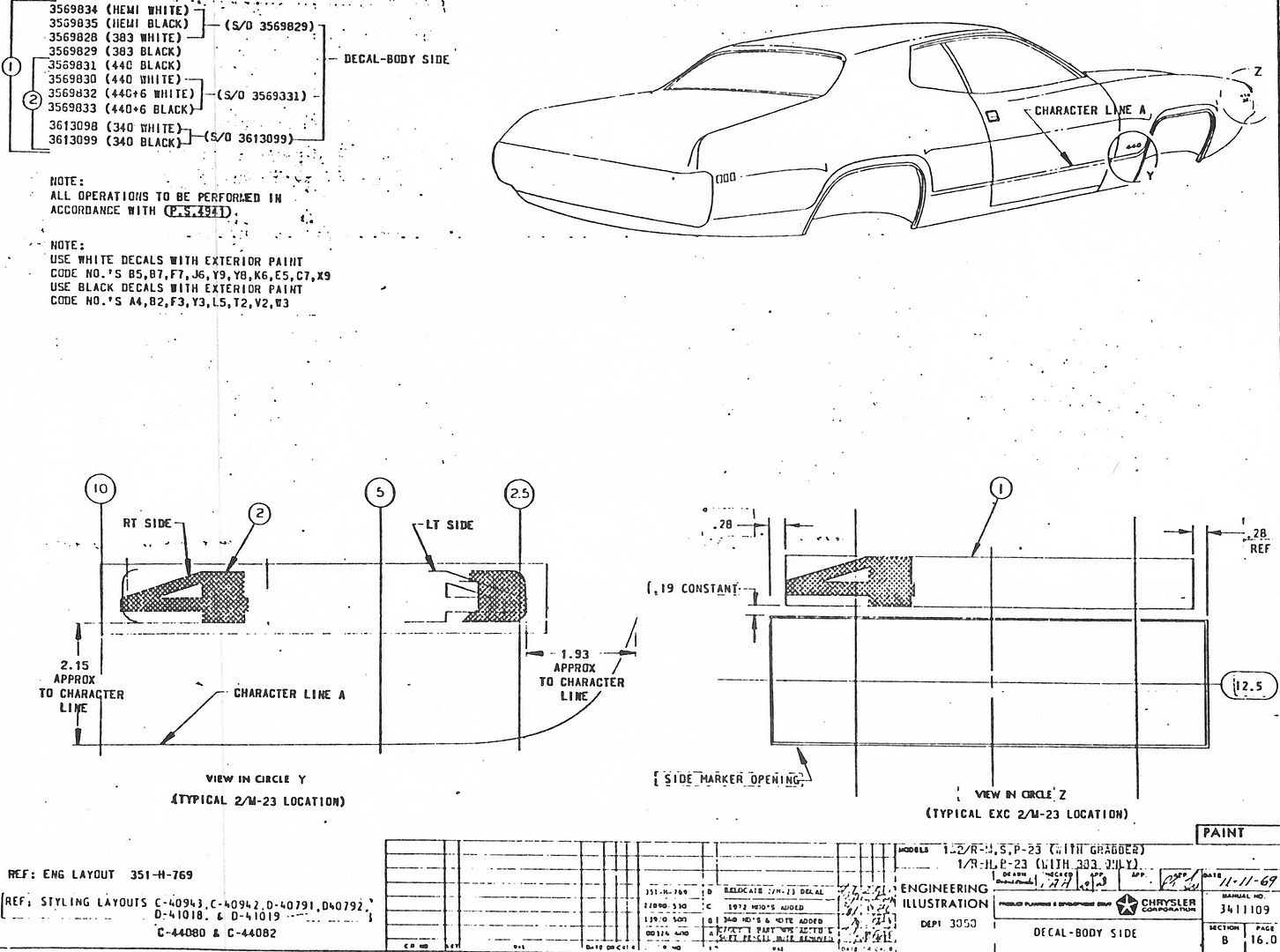

i have the answer
for above the marker
In 71, the standard 383 cars did get callouts. For 72 the standard 400 did not.
so no above the marker on a 72, it went on the dogleg on 440 cars only
here is some reading on it
http://board.moparts.org/ubbthreads...e-1972-road-runner-fender-engine-callout.html
Learn something new every day. I have never seen them behind the wheel well like that, only above the marker light

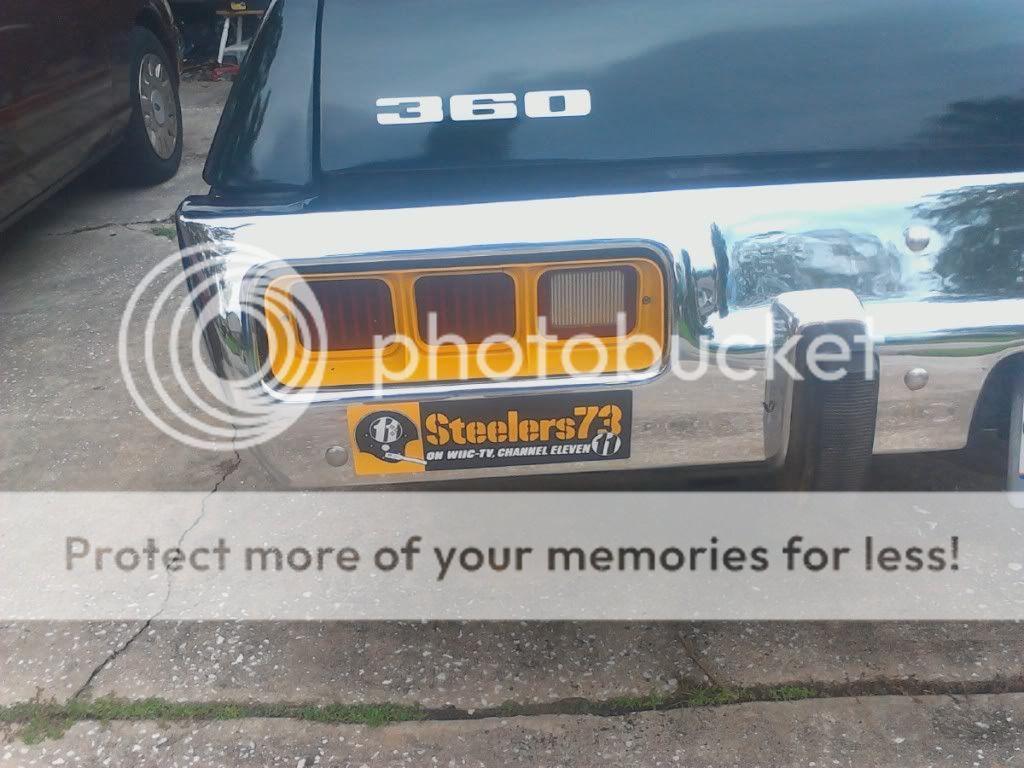

I put one on the trunk lid of my 74 just because I got tired of people coming up from behind the car asking "what ya' got in there?" :)
