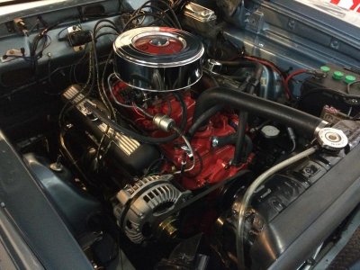

I'm a bb guy but if your starting from scratch you could buy a 360 complete with trans. and all the extra stuff like steering powerbrakes and air all in one shot and it's an easy do.

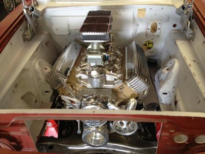

This is the direction I'm going with my 64...it's hard not to stop and stare when you pop the hood and see this. Prices have obviously gone up since this article was published...but it's still a whole lot cheaper than an original Max Wedge. Also, don't get rid of the poly. It can also add value, especially if it's original to the car.
http://www.hotrod.com/cars/project-vehicles/ccrp-0711-1964-mopar/
