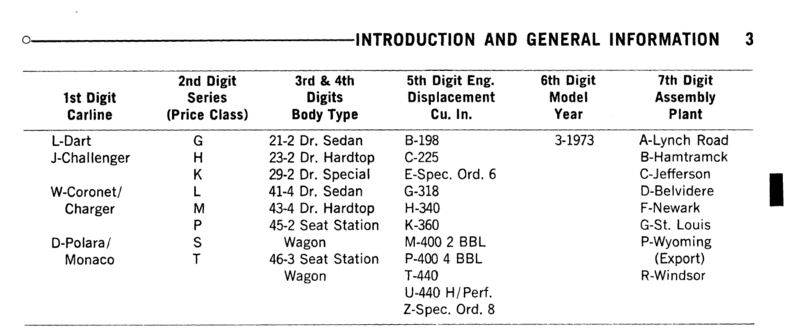

Well I wouldn't have believed it, if I hadn't seen it. This is from my 73 FSM;
Isn't there at least one reference where it specifically mentions propane?
GTE had quite a sizable fleet of propane powered v6 Dakota's.
Finding the reference in a FSM and finding and actual VIN are two different things. I’ve been actively seeking tags and documents for 15+ years and have never seen a Z VIN code in a dash or fender tag.
I know guys looking longer than that and they’ve never seen one.
unicorn?
unicorn?
out of everyone on this site, and no discredit to any one else, i thought you would have been the one that could show a tag or some other documentation to such an animal. I wonder if one does exist
