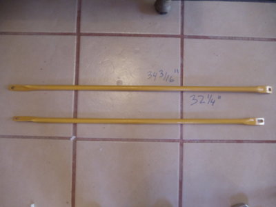

Be aware when shopping for these, 72 b-bodies are 32 inches center to center on the drivers side and 30 inches center to center approximately on the passenger side. 73-74 are longer, I found out the hard way.
T2R9, are you going to reveal where you shopped/found yours? My search continues, im hoping I have some luck at Carlisle next week.
The ones pictured are my originals. My passenger side was bent pretty good so I tried to replace it. After getting two that were wrong, one here and one on ebay I went ahead and straightened out the one I had the best I could and used it. Bring a tape measure with you to Carlisle and you should find what you need. I love that place, this will be the second year in a row I will miss it.

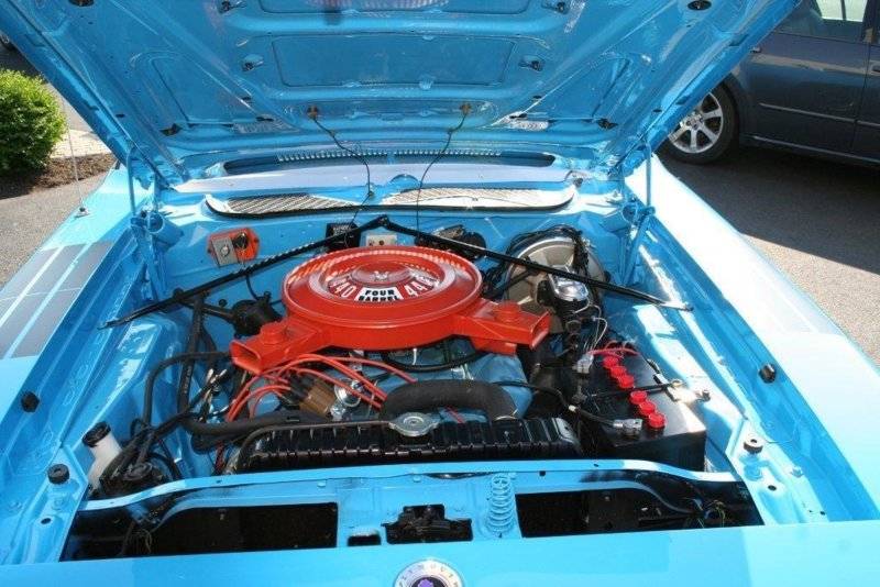

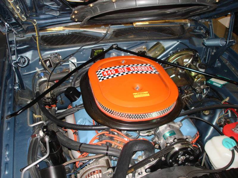

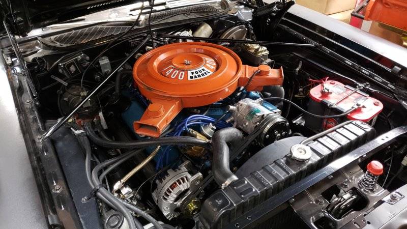

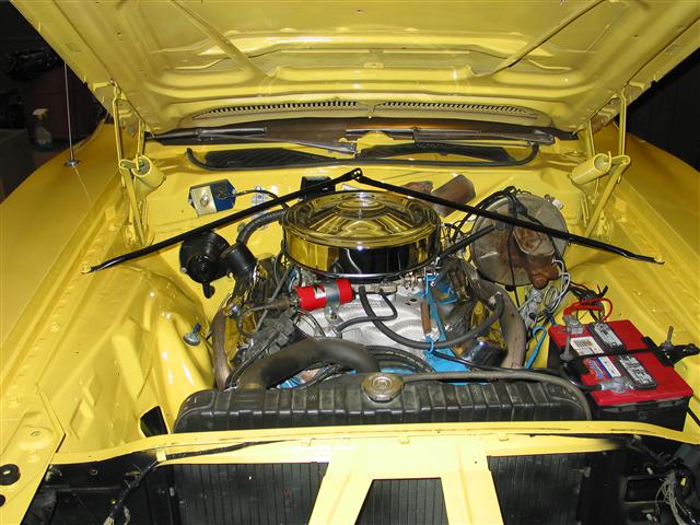

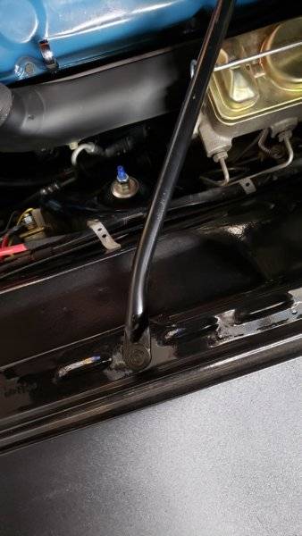

For ’72, first year for these factory braces on the b-body, it was big block applications only. They are not really beefy enough to stiffen the entire front of the car. Likely to help control the lateral movement of the upper fenders. The ’72 versions are one year only, they have some slight bends the later years did not have. As mentioned, the ’73 and up are slightly longer and are straight, without the ’72 bends. By ’73 the braces were more common across the engine options.
In my time at the dealers back in the day, would see a lot of them on the old timer’s benches, or in the garbage after any serious engine work requiring their removal. Seemed like it was too much trouble to put them back on.
Pictured here are a set of the original ’72 braces, note the slight bend in the middle of the passenger side, and clearance bends near the forward ends, allowing room for the hood hinge when down.
Second picture shows a set of later braces modified to fit my other ’72.

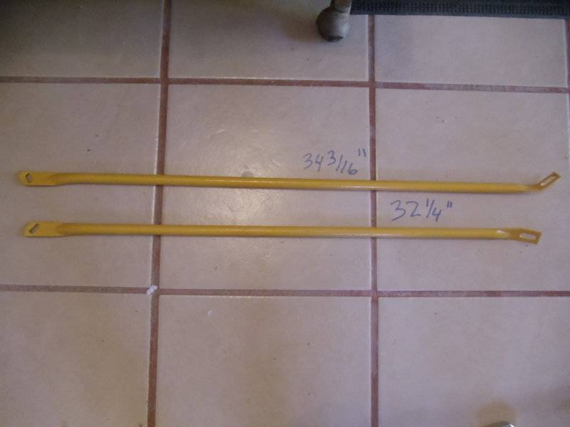

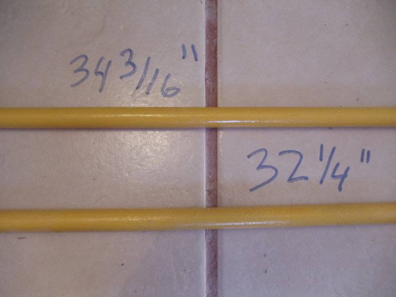

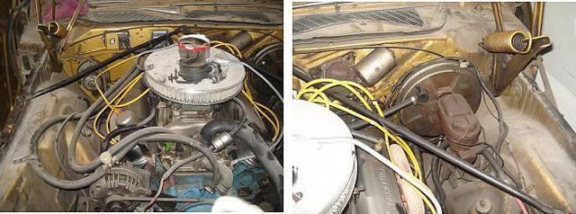

I purchased a used pair for my '72 Satellite Sebring Plus but now I have my doubts if they will fit, I had no idea the design was changed after '72. I don't know if my used set are '72 versions or the later ones. In foto three, I flipped them over 180 degrees from the way they were pictured in foto two. They seem to be pretty straight. The measurements are from the very end/tip of one side to the very end of the other side.
I would be interested to know how to modify the later ones for a '72 model (just in case). Thank you.
I don't know what post #7 means by "center to center" 30" and 32", the bolt holes on mine are slotted more than 1/2" on one end and more than 3/4" on the other end, that's why I measured them tip to tip.
Those look to be the later versions. The outer bolt holes will need to be drilled to fit the ‘72, slotted end removed. A slight bend will need to be added at the outer end of the brace to provide clearance for the closed hood hinge. If not running an Air Grabber air filter base, the mid bend in the passenger brace is not needed. Again, these are simple hollow tubes, fairly easy to bend.
The one year only ’72 version are rather scarce these days, whatever you can get for them I would imagine.
So. Surprised that they are hollow and slotted! How much can they really do?
I would think they will flex and possibly move in the slotted holes under stress.
