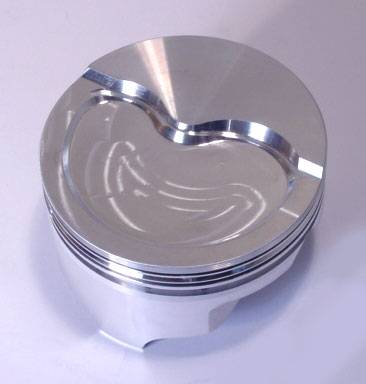

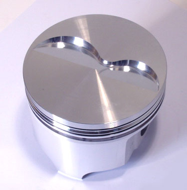

Here are pics of the 2 pistons.

What heads? I would guess its because of the quench pad on the new pistons. It has a more efficient burn if it makes power with less timing.

Yes, the better the head design and the way the pistons match the heads, the more efficient the burn. The more efficient the burn, the less max timing needed.

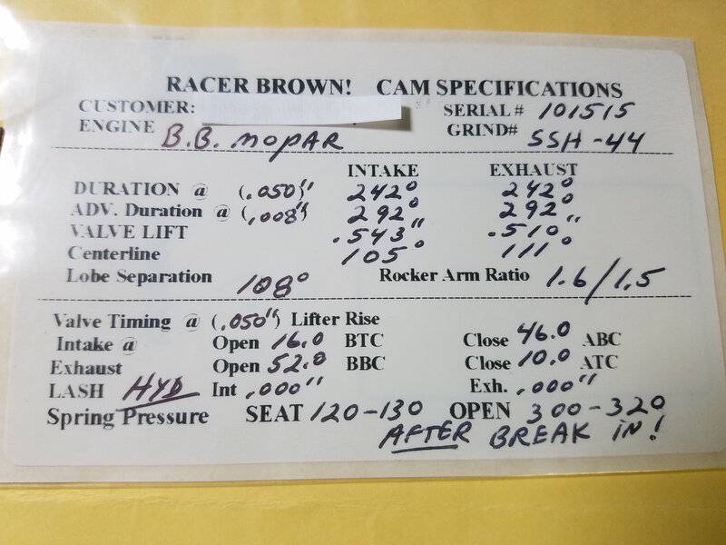

@hunt2elk - I’m curious what camshaft you have? Those source heads- are they 84 or 88cc or something like that?
Cam is a Racer Brown, here is the card on it. I had the builder measure both pistons when in the motor. Going by Source's charts on their stroker page, comparing the CR, they are 79cc.
