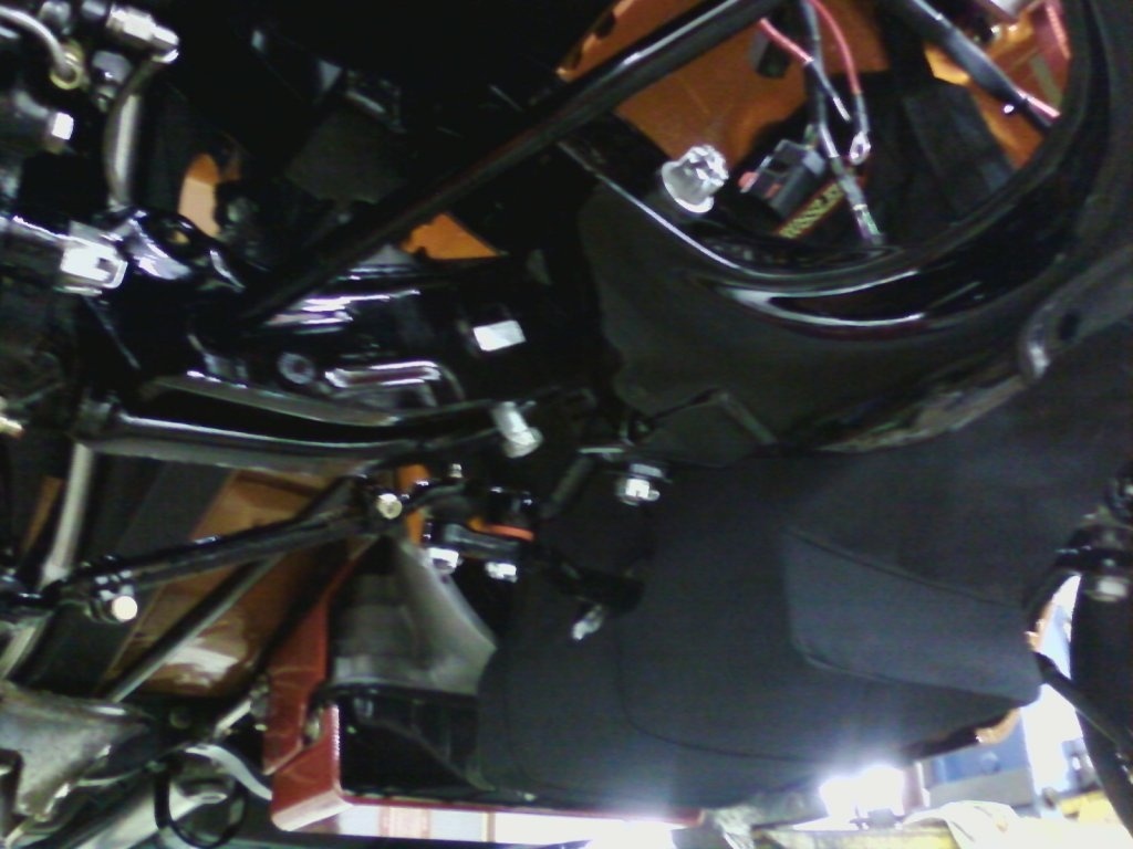

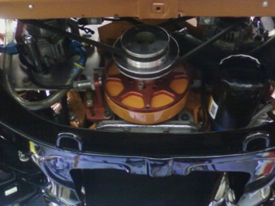

My 64 Belvedere has a Rustler II. I sent them a drawing of my pan. Fits very well. My sons SB turbo 62 Plymouth has one as well. The headers aren't on in the picture.
Doug
