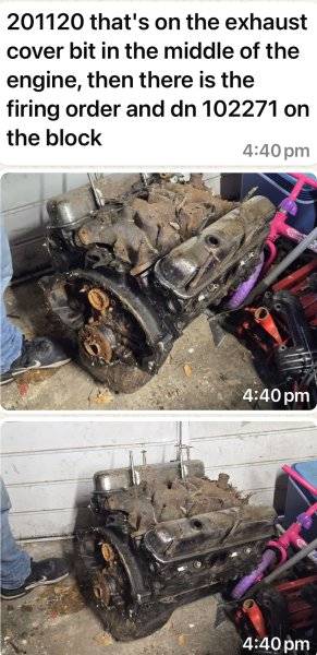

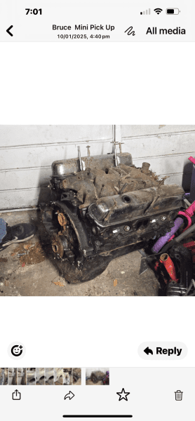

Hi from the uk I’m asking if these numbers mean anything to you dn 102271 trying to find the size and bhp would like to put it in my 66 satellite and what box should it have please any help great fully appreciated
You need the #s right below the ( passenger side in UK!) Cylinder head. On the front of the block where the p/s pump would go
Have a look here.. Then send the info to the seller to get a better set of numbers.
