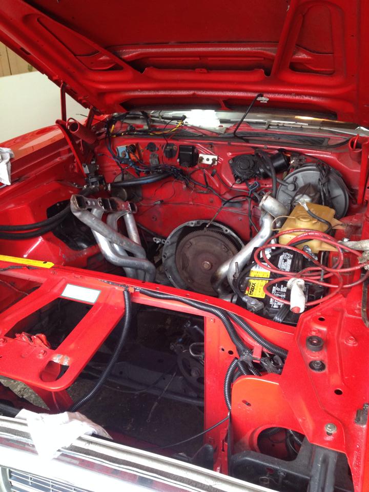

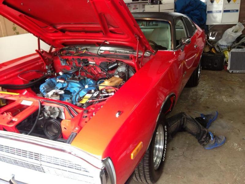

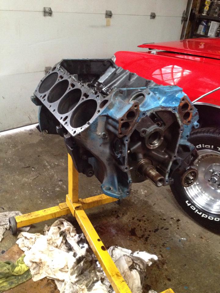

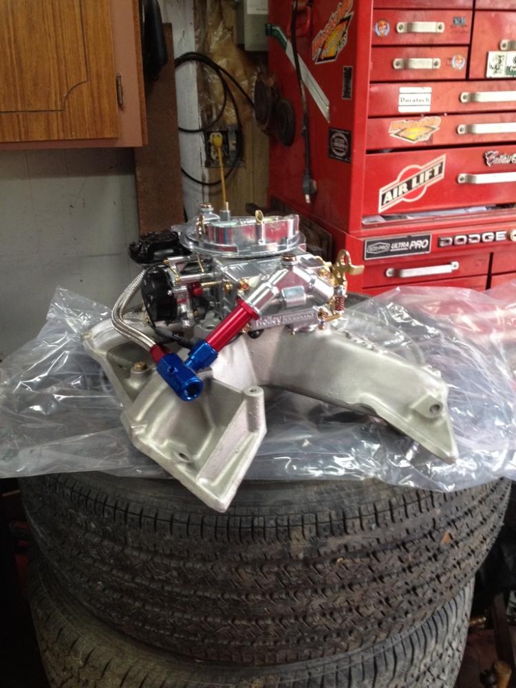

I took my 440 out of my 73 Charger this weekend past. Figured I would post a few photos on here! I have most of my parts now just waiting on a few things.
10.1 compression
Lunati 280/280 .513 lift custom grind cam
452 heads ported and polished
Comp 911-16 springs
Mancini heavy duty chrome-moly push rods
Johnson hydraulic lifters
Comp magnum timing chain
Edelbrock TM-7 intakemanifold
Holley street avenger 870 electric choke/vacuum secondary
Holley blue electric fuel pump and regulator
All steel braided Russell hose and fittings
TCI streetfighter converter
4.10 gears suregrip
Mickey Thompson E.T streets 28x11.5r15
Will post pics as I'm going :icon_winkle:

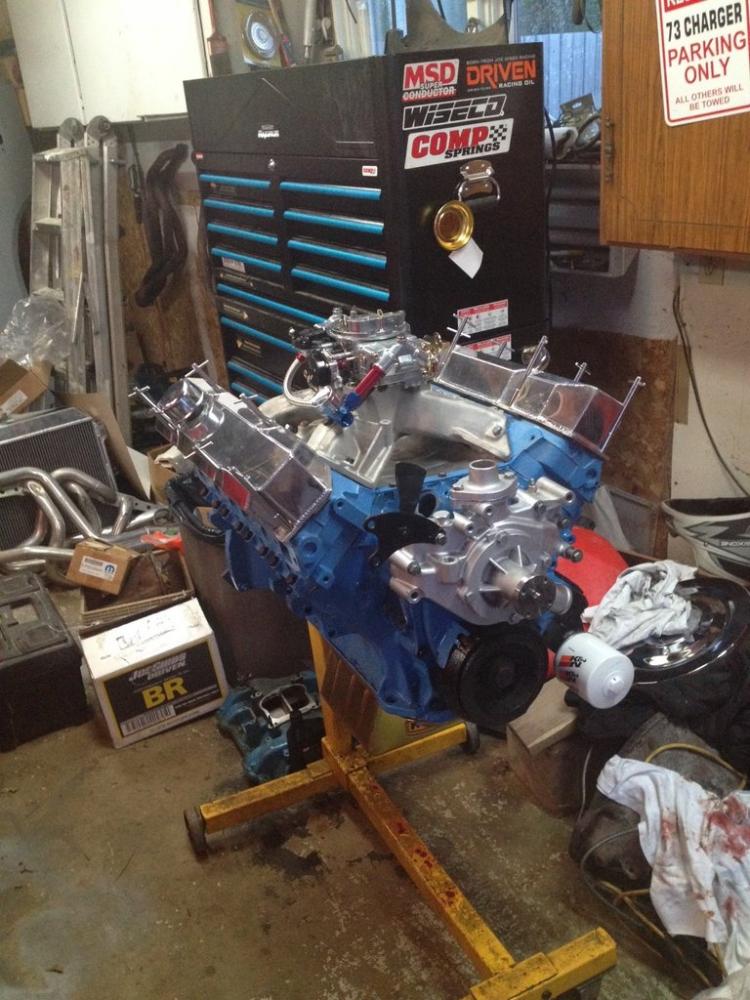

Well I finally made some time yesterday for myself so I went out in the garage and I put my engine back together. Now I have to make lots of time this week to put it back in, and swap out my 8.25 for my 8.75 that I rebuilt with a 489 case, Auburn limited slip and 4.10 Richmond gears.

Looking good!
Does your engine stand become a little scary, when you get the whole engine assembled? I know mine does...
Looking good!
Thanks! Yeah it does get kind of scary, I certainly wouldn't want to be laying underneath it! Lol
looks good let us know how it runs when you get it back in the car
Looking very nice! Hopefully the weather takes a turn for the better! As for the brakes....you could always convert it to manual.
