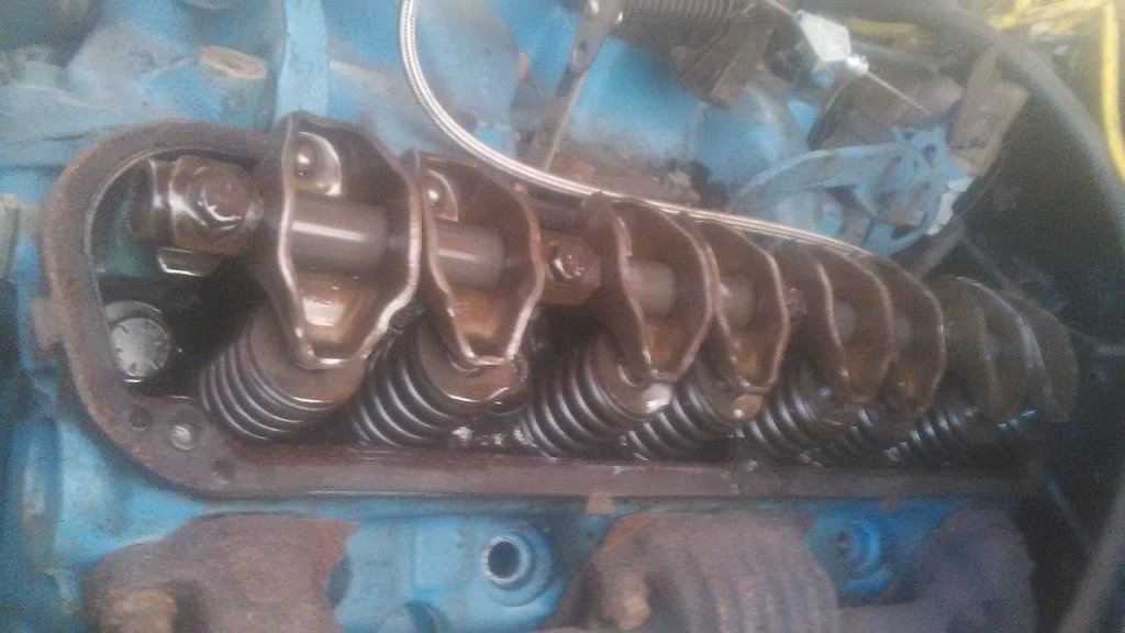

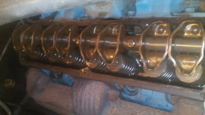

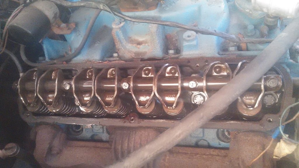

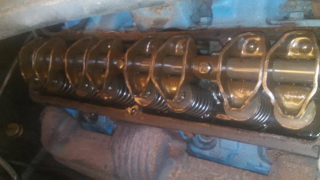

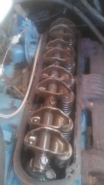

Valve springs looked good visually and seemed ok when turning the engine by hand but I won't be able to rule it out completely until I look at them while its running. I was also thinking about the possibility of a warn lobe on the cam, I know it can cause some of the symptoms I am having. Tonight I am going to take a closer look at how much each valve is opening when I turn it by hand and then if I have time to make a mess and someone to help I will get them to crank it and take a look at it under power, I think its really the only way I am going to track this down.

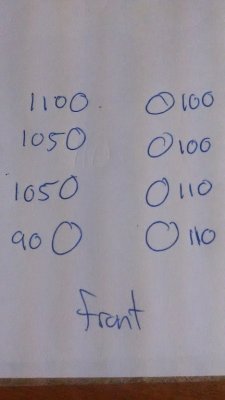

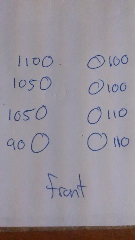

I don't actually think its missing, its not shaking, I didn't clearly hear a miss when it was running but I was more focused on the knock. I have a buddy coming over on Tuesday and he is gonna crank it for me while I look at it, should be able to locate it then. In the meantime while I was by myself I rotated the engine by hand and checked the travel on the valves, see if I could clearly see one not opening all the way and although I didn't measure them they all looked good. I also did a quick compression check, I haven't done one since I bought the car and was curious to see what I was working with in general, it was done cold because I didn't want to run it long enough to warm it up until I figure out what the knock is, results are attached in a pic, issue in #2? I did it at the beginning and again at the end and got the same reading both times. I will have to do it at temp once its fixed.

Yeah, #2 is low...I'd put a eyeball on it. If you still have the covers off, any chance one of the pushrods for #2 is bent? And, take a look at the tappets, where the pushrod end sits in the tappet 'cup'. With both tappets bottomed on the cam lobes, the tappet piston (cup), should be slightly pushed down, .010-.020 down from the retainer. Push on the rocker arms, to see if either tappet piston is hung. Of course, look at the cam lobes for wear.
Previous motor I fooled with had over half the pushrods bent, but on top of that, cam lobes looked okay, but many of the tappets had bad wear at the contact surfaces.

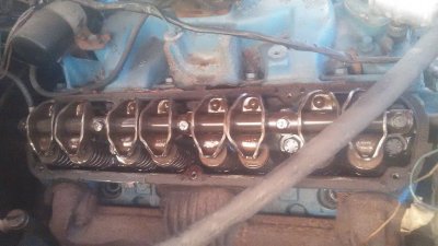

Hard to tell in the pic but did anybody have the rocker back bones off and got all the rockers mixed up and just put them back on not knowing that the intake and exhaust rockers are different ? If they are on wrong , the push rod is pushed to the side and can hang up or even be slowed down during the engine running .
If you have a timing light, shine it on the valvetrain. The strobe effect will let you see things that you wouldn' t otherwise. I once caught a bad lobe this way.
