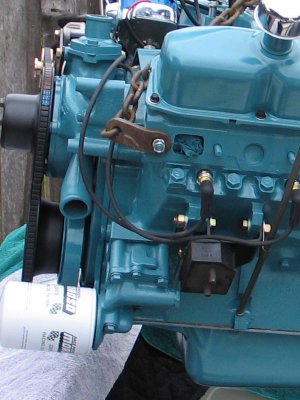

Hey can some one do mr a favor and post a couple pics of the engine mounts in a 65 dodge coronet with the engine in the car. Im having problems with my engine sitting to far forward and the zbar studs don't line up from the frame to the bell housing. thanks
This is from my 64 which should be about the same... I don't have a good pic with the engine in the car, but this should let you figure out if your motor mounts are set up correctly. Good luck.
Motor Mount's
The steel engine bracket's are 62-65 B-body specific........ any bracket's off
a factory 361,383,413 motor's will work. Do you also have the rubber isolater's
as seen in the previous pic, as they are only specific from 62-65. I do have a pair of new Sealed Power Isolater's in the box if you need them. Hope this help's. Good luck
