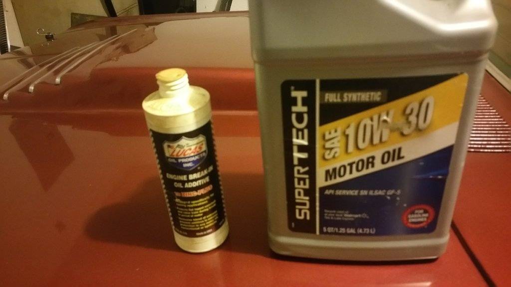

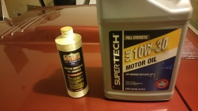

I use walmart supertech and would add Lucas engine break in oil additive when I ran a solid cam. I went solid roller now so only use the oil now.
