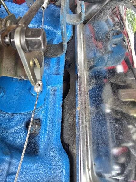

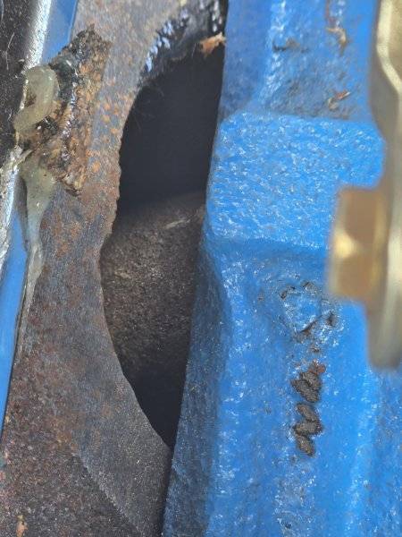

So I just bought this 67 Coronet 500, There was a 440 installed and it looks to be a 1979 engine. It has been freshly rebuilt. My question is what is going on between the head and intake manifold? I have always built Chevy hot rods so this is my first dodge so don't know to much about 440's. It looks to me like its the wrong manifold on here or wrong gasket? I will be pulling the motor any ways to repaint it the right color and also to repaint the engine compartment. I was thinking of installing an intake and headers as it does have a small cam. Get rid of the points distributor and go electronic .

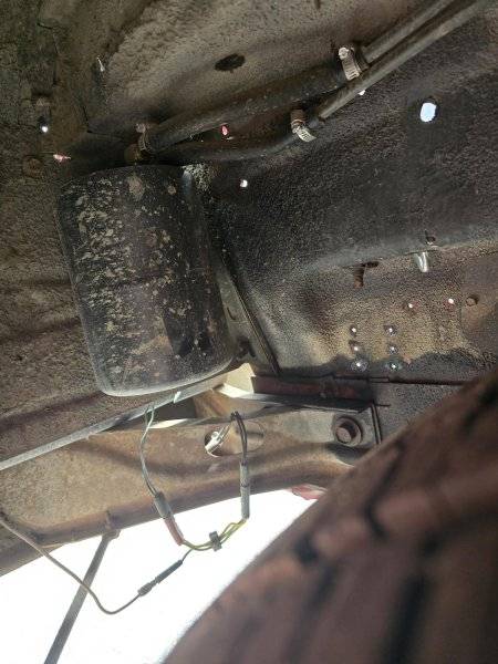

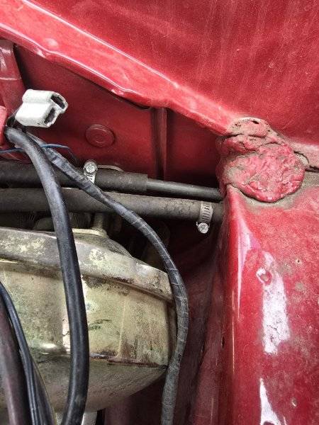

Another thing is a found the canister under the driver side front fender. two lines come out from it and through the inner fender right behind the brake booster but not hooked up to anything. Thinking it could of been a vacuum canister but why?

that 1st & second photo
No that manifold looks to be for a 440/RB intake at a min
it's the right gasket too
that's part of the (chike/intake) heat riser passage from the heads
it doesn't have anything to do with the intake seal or gasket goes
if you want any power out of it (heat kills power)
get a gasket that blocks that 'heat riser' off
especially if it's not driven much in cold weather,
I guess it depends on the type of choke too,
an electric choke doesn't need it
the heat comes from the exhaust to shut off the choke stove spring when warm,
if it's stock choke

Thanks
Right now it has a manual coke which is not hooked up. I would prefer an electric coke so may change the carb. So what is a 440?RB intake? If I go and replace this intake with an aftermarket one, I just need to make sure I get a gasket that will cover the whole head to block the holes off then?
I did figure they were for heat that is suppose to line up with ports on the intake, that why I was kind of figuring that was the wrong intake for this motor.
