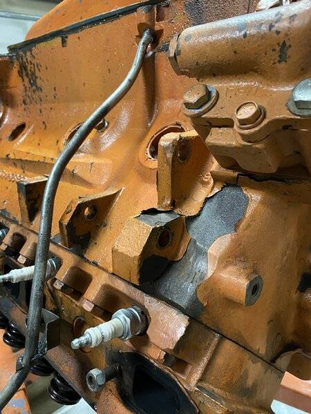

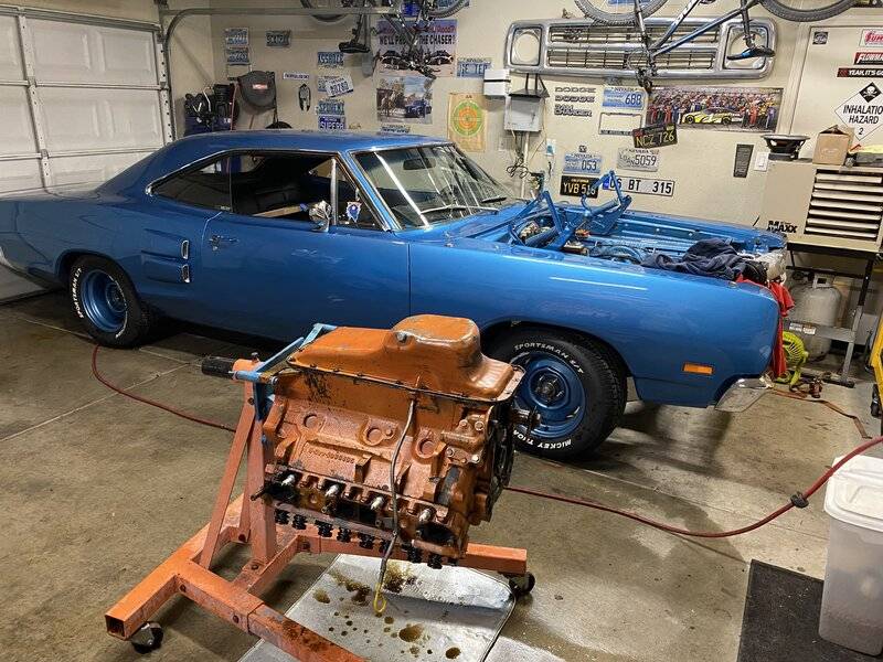

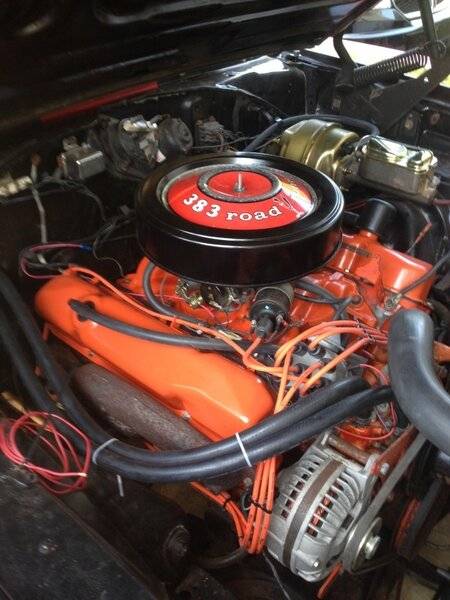

Yanked my 440 out in preparation to 4 speed swap my Bee. I’m going to reseal the 440 and clean things up since it’s been in the car for 20 years now and leaks oil from everywhere.
I’d like to repaint the engine before it goes back in. I’m looking for ideas on how to prep and/or remove the old paint before I spray it again. Any suggestions from the pro’s here at FBBO?
