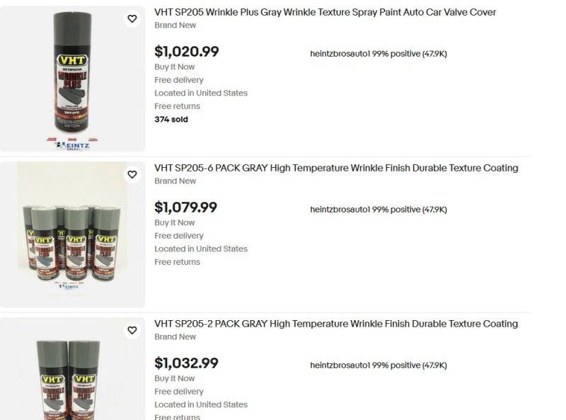

I found a source online that has NOS VHT engine grey wrinkle paint, but is asking $926 +tax for a single can, he will graciously include shipping.

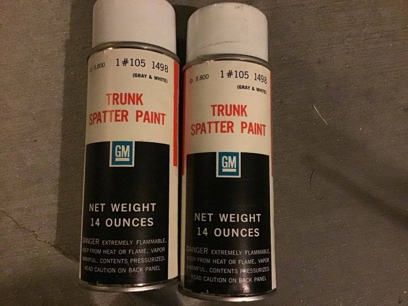

I have two of these I'm not using

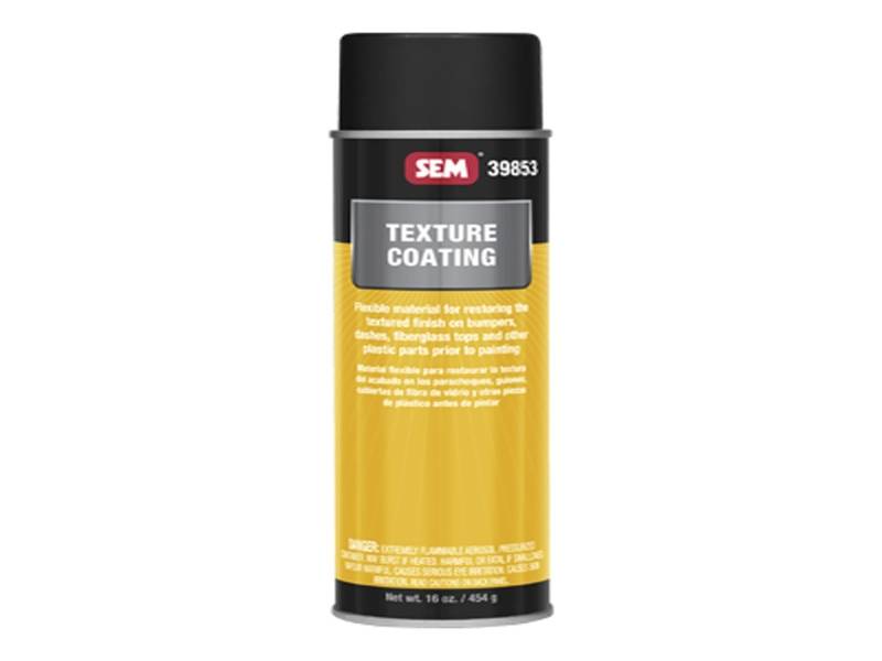

You might look at SEMs texture paint for vinyl surfaces. It’s intended to replicate vinyl graining. However, it’s black too. The degree of texture is controlled by the spray distance and speed of the pass. I usually sand it very lightly with fine sandpaper on a wooden block to flatten the raised surfaces to look more like vinyl texture but it can be left as sprayed and topcoated with other paint.
There is also that anti-chip coating applied to rocker panel areas if you need something with a texture more along those lines.

Only $926? that's a bargain compared to this guy.. you got a choice, 1bbl for $1020, the A12 edition for $1079 or the dual quad for $1032..

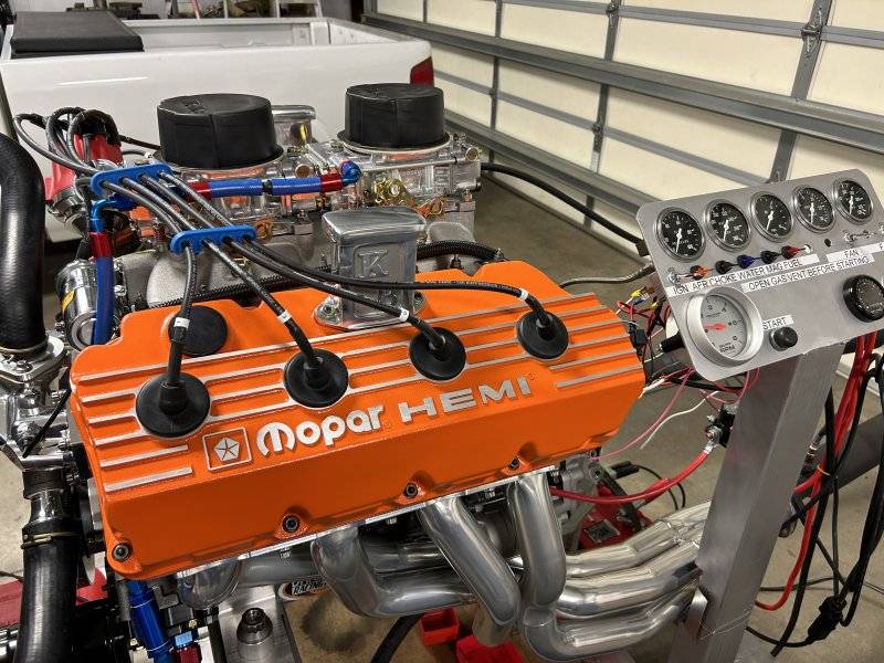

I wanted wrinkle orange for my valve covers. (I think Mopar used to offer valve covers that way.) I had these black wrinkle ones. I was afraid if I tried to spray orange over the black wrinkle it would smooth it out or worse yet be smooth in some places and still wrinkled in other places and just look terrible overall. But I gave it a try anyway. And it turned out perfect. It took all day because of having to sand off the fins and lettering but I am very pleased.

Also, Duplicolor sells in a pre-mixed quart that you apparently can just load into a gun and spray if you have one. Duplicolor/VHT have dropped the grey spray wrinkle, only red/black now, that's why the Ebay folks want your left and right nut for them..
